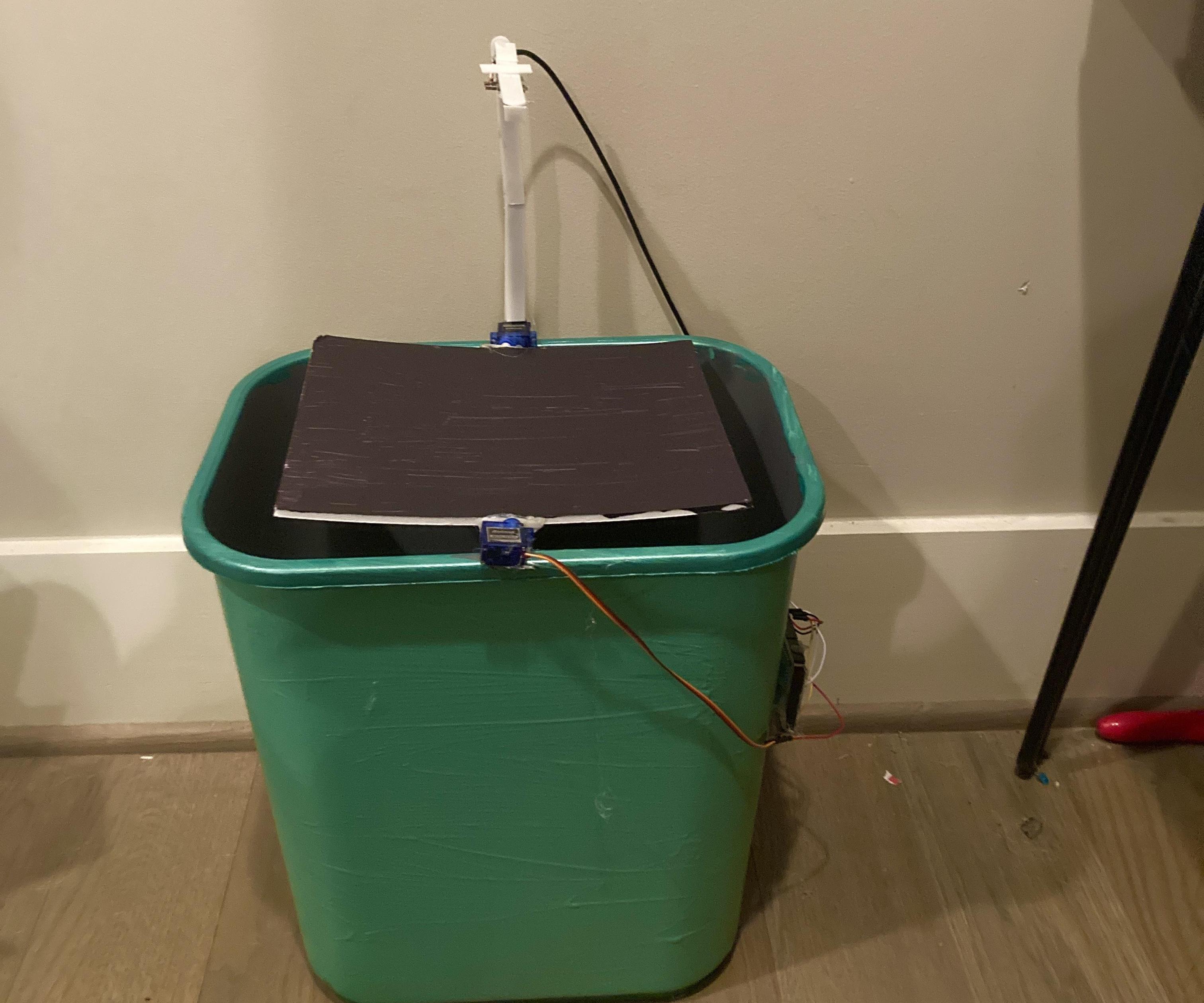

Step 1: Set Up Your Frame
It is important to start with the framework in order to mount each of the 4 motors. This will allow us to secure the slider that will hold the drawing utensil in future steps.
  1. Cut 4 blocks of wood. The blocks should be about 2-3 inches tall. If you don't have access to certain wood an 'L' shaped cut will work.
  2. Attach the rods to form a square like shown in the diagram. It should form a square, 4 blocks on the corner, attached by 2 rods on each side.
  3. Attach 4 motors, one to each corner of the frame. Attach your bearings to the motors. Two should be perpendicular, both pairs on opposite sides.
Step 2: Making Your Sliders
This will make 2 pieces attached by one. This will be the part that the motors will manipulate.
  1. Attach timing belt to both bearings on both pair. This will make two perpendicular lines with the timing belts.
  2. 3d print a piece that had two holes in the middle of it. Slide both rods through the holes. If you don't have access to a 3d printer like me, a smooth surface such as Legos or wood will work. I found Legos to work better.
  3. Attach 2 motors on top of the 3d printed sliders, perpendicular to each other just like the other ones.
Refer to the attached images.
