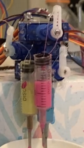

Step 1: Creating the Pumps
The first step is to create the three pumps. For this step you will need three syringes, string, and your three nails. Repeat the following steps 3 times:
1) Pull out the plunger and remove the small rubber piece at the end. Drill a hole in the center. This hole should be just big enough for a string to run through it. Make sure it is not too big as that will release needed pressure.
2) With the remaining barrel of the syringe, make a cut using a knife somewhere around the 2 mL mark. Keep the end containing the tip, and discard the rest.
3) Tie a string to the head of your nail. Push the nail through the small rubber cap. Place the nail through the tip of the syringe. Place the cap at the other end of the syringe. Make sure the end of the string is outside of the syringe.
The pump should look like the attached picture. Hold these on the side, as they will be used later.

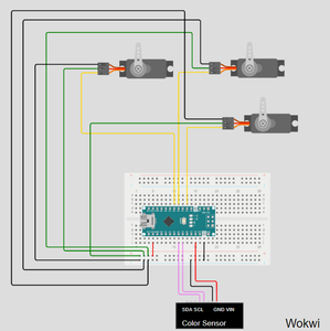

Step 2: Circuit
Connect the circuit as shown in the picture. Then connect the servo motors by "stacking" them. Rotate

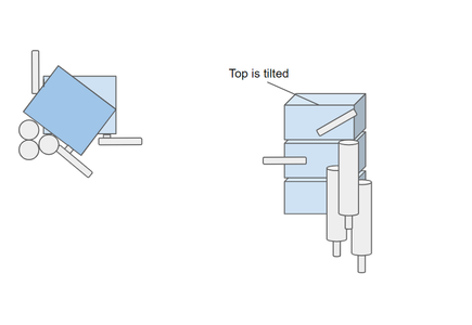

Step 4: Putting It All Together
Every component is now done. Now, we just need to put it all together, and compact it into a smaller space. For addition aid in this step refer to the third diagram above.
To do this, hot glue the servo motors as shown in the diagram. Make sure the extension sticks are on. Then, take your pumps, and make sure the nail is resting in the furthest down position possible. Then, tie the string to the servo motor respectively. Do this with all three. After this, attach a 9v battery to power the Arduino nano to the back of the breadboard. Then, glue the breadboard(make sure the color sensor is attached to the end of the pen), battery, and servo motors together as shown in the second diagram.
