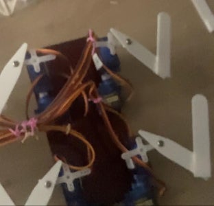

Step 1: Make Joints and Body
This project can be split up into 2 major steps. The code, and the structure. Once the body is built, and the joints can move independently, it is up to you to create its functions. I will give you a few later on.
Building the body-
  1. Cut out a rectangle. This can be with thin plywood, 3d printed, sturdy plastic, or anything else you can find. I use some red plexi glass.
  2. For the individual joints take 2 servo motors. attach one to the side of the other like shown in the pictures above.
  3. Cut out or 3d print 4 legs. I found that about a 75 degrees angle works best. Attach these legs to the outward servo motor like pictured above. As for the legs, find a good level of friction for then to work.
  4. Then use a breadboard and Arduino Mega to wire up the servos. The servos should have a pos, gnd, and pin wired to it.
That should be it for the body. It should look like a rectangle with 4 legs and 8 joints attached to it.
