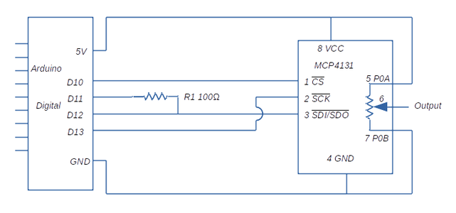

The schematic of the circuit and a completed breadboard version is shown in the images.
Brief description of the circuit:
  1. The Arduino communicates with the MCP 4131 via the SPI bus
  2. D11 to D13 on the Arduino are configured as the SPI communication bus
  3. D10 is used as a Chip Select signal. This is configurable by the user
  4. Because of pin limitations on the MCP 4131, incoming and outgoing SPI communication is multiplexed via a single pin 3
  5. Resistor R1 is required in case of volt difference between the Arduino and MCP 4131. Because the Arduino and MCP are both working on 5V, 100 Ω is sufficient.
  6. Output is set up as a voltage divider and will nominally vary from 0 to 5V.
