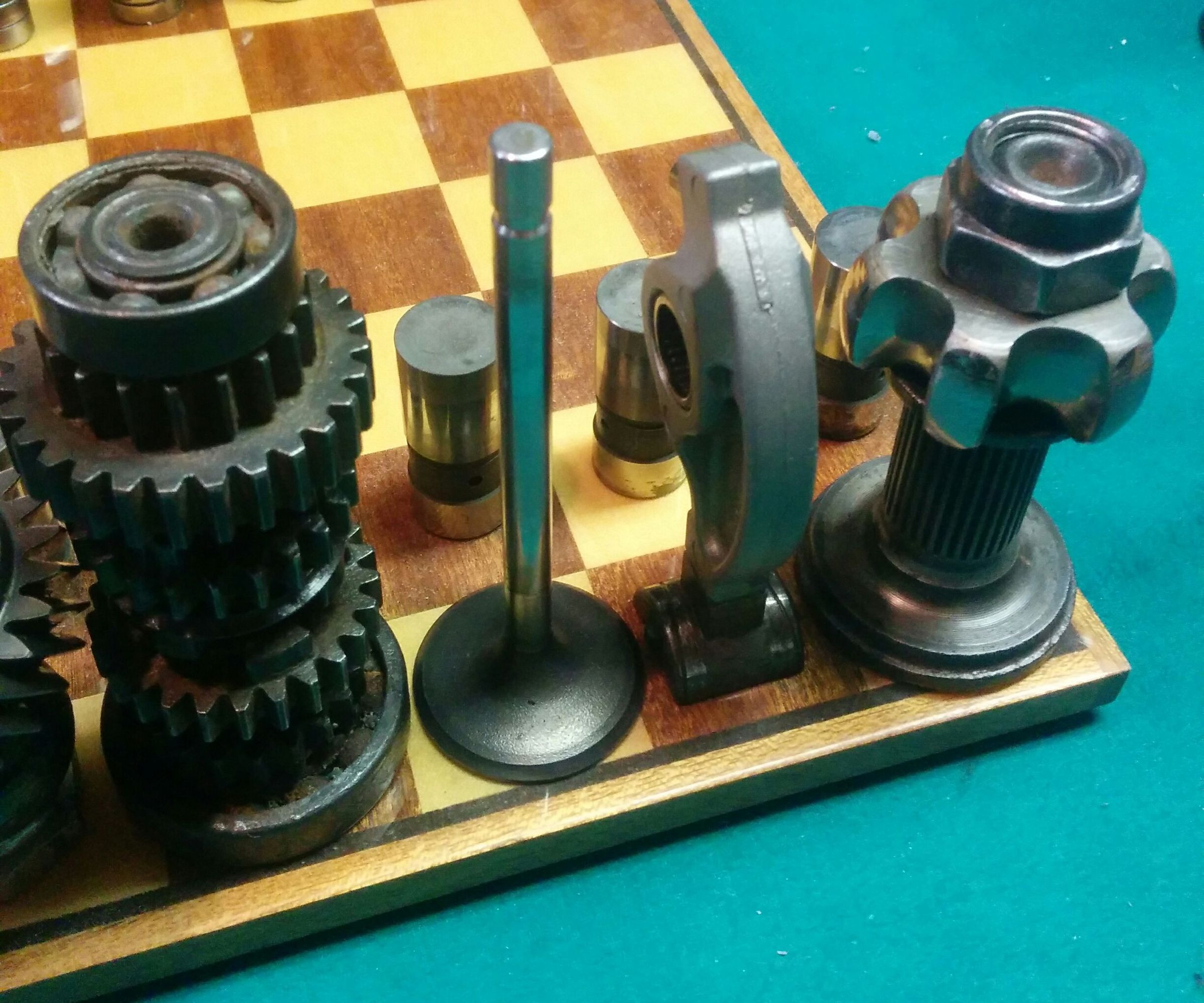

Step 19: Release the Castle.
As Roy Scheider said in Jaws "We're going to need a bigger chessboard!!!" I like this piece because it can be disassembled/reassembled and re-modeled easily because there is no welding required. Have fun and thanks for viewing.
