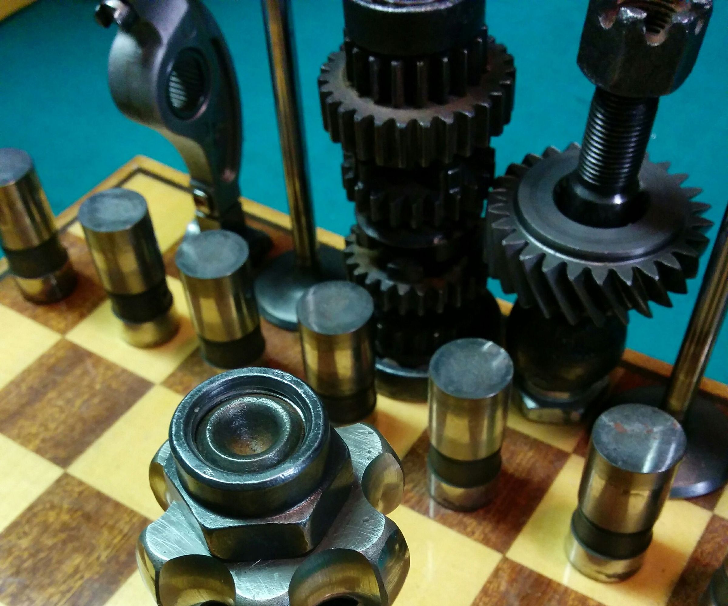

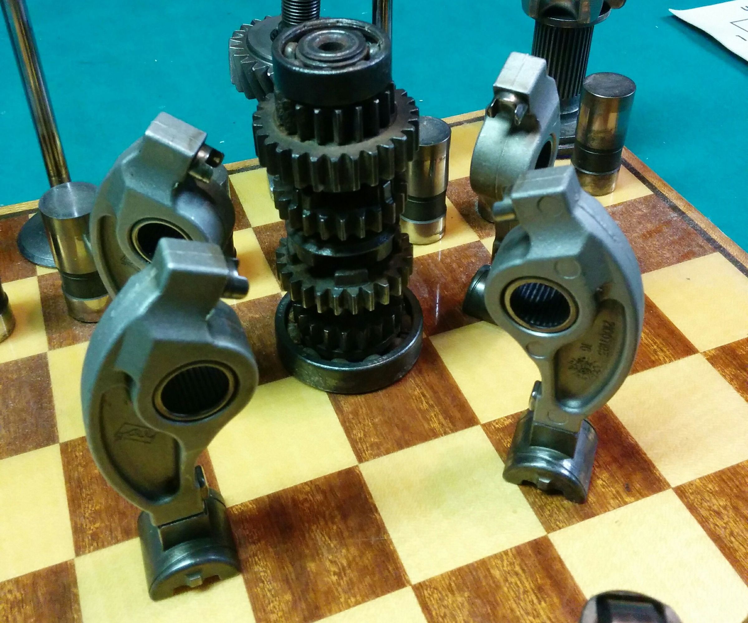

Step 11: The Valve As Bishop.
This picture shows the finished valve proudly taking his or her place as the bishop between the rocker knight, and the lifter pawns, in the court of the Gearbox King. I'll try to publish another instructable for the CV joint castles with the corinthian fluted columns. Also check out the excellent Car Parts Chess Set by TuftyFall0.
