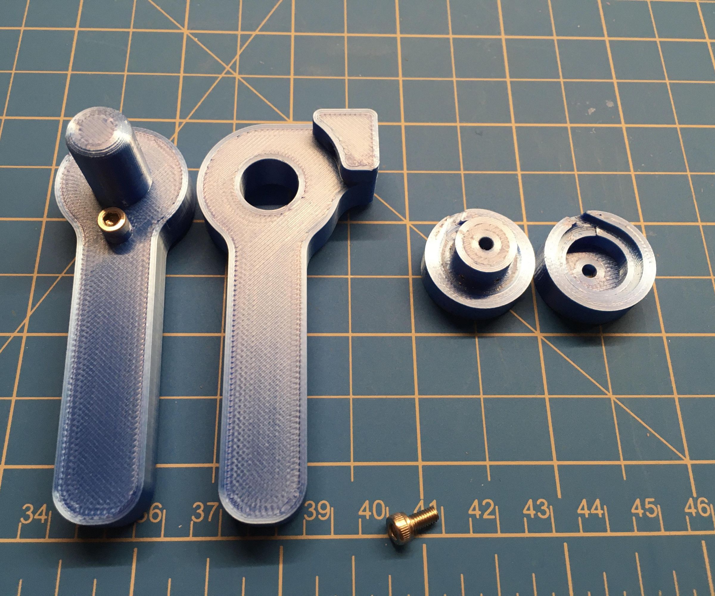

I created these handles in order compensate for an Xacto blade's angle. As shown in the second photo, this makes the cutting edge steeper, which is better when doing precision cutting as it keeps the point downward without the need to uncomfortably hold your hand upright. A resin printer will likely yield the best results, but I printed this on my Prusa MK2.5S and it turned out great.

Step 1: Printing the Handle and Cap
Update 10/29/20: I have created a much stronger and more functional design for the purpose of FDM printing, but it still has the same assembly instructions.
Xacto Handle V1 files and info here: https://www.prusaprinters.org/prints/41096-v1-bett...
Xacto Handle V2 files and info here: https://www.prusaprinters.org/prints/41102-v2-bet...
V1 Print instructions
As mentioned before, I printed my parts in PLA on my Prusa MK2.5S.
Print the files at 103% scale, with a 0.1mm layer height, 2 perimeters, 20% infill, and a brim.
Do whatever PLA temps you prefer.
For the long handle, slow down your print speeds.
V2 Print instructions
Use whatever settings you prefer! The handle is already scaled, and since it prints flat on the bed, you don't need any special settings.
For reference, I used 0.2 mm layers height, 2 perimeters, 20% infill. Optionally, use a brim. You will need to cut/drill out some material from the bolt hole, which is there to prevent the need for support material.
