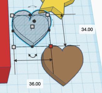

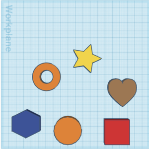

The shapes I chose were not random. Each shape was chosen specifically to give the child a range of difficulties while configuring the product. For example, the circle is a relatively easy shape to match because in can be placed in any direction and still fit into its desired place. On the other hand, the heart is more difficult to place since it can only be placed in one position to fit in the correct spot. I created the shapes by placing them on the work plane, assuring that they were symmetrical, then raising them by 10 millimeters.

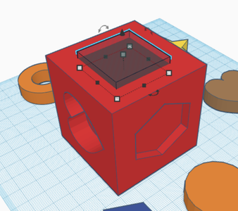

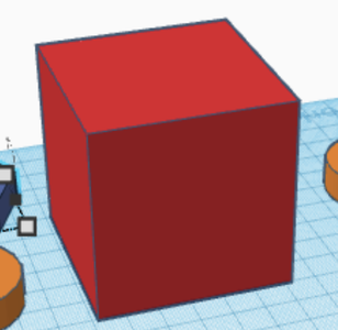

I decided to use a box as the base because of the six equal planes I get out of it. The dimensions of the cubed base are 60mm x 60mm x 60mm. Each plane holds one shape. After creating the box, I duplicated the shapes that I had, added 2 millimeters to each side of the duplicate, and made it a hole.
Step 3: Inserting the Place Holders Into the Base

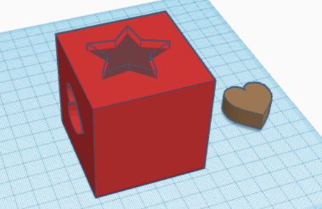

Then, I aligned each hole to one plane of the base and lowered it two to three millimeters, depending on what appeared appropriate. After I determined the hole was in the correct place, I grouped all of the holes to the base, creating the final Box of Shapes.
