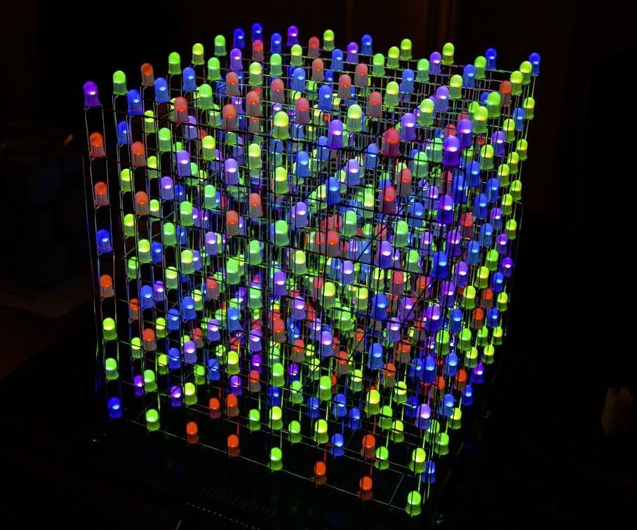

Step 1: There's Got to Be a Better Way...OR "Building the Perfect Cube".
I thought "If the LED leads were on the edge of the LED, it would be a snap to line them up.
So it hit me...MOVE the anode to the outside of the LED. If the anode coming from the LED above was on the outside edge, the LED below could sit directly under the LED above it. And if the legs were on the outer perimeter, they would line up easily to be soldered. Not only that, it takes care of measuring because if you solder the leads at the point where they meet, it would always be the exact same distance every time!
So I started bending the leads in this manner, but I was soon suffering from finger fatigue, and it was hard to make the bends precise. Once again, I was thinking there had to be a better way. I tried to think of how a machine programmed to do this automatically would work, and how I could emulate that machine manually. After much thought, I had an idea.
So I made a small jig out of an old X-Box heat sink, but you could use almost anything you can drill a precise hole into that won't easily wear.
Drill a hole the exact size of the LED you are using. If the hole does wear or is a bit big, stick some tape over half the hole, and shove in an LED, and then stick the tape down good. The LED will bring the tape inside the hole and make it a tighter fit. Once the tape is nice and secure, remove the LED. You want the fit to be snug, but not so tight that it's hard to remove the LED.
Mine would be snug enough that I added an aluminum "eject" lever as well to help pop the LEDs out of the jig.
I tried to loosen the hole up a bit, but then had to add tape because I widened it too much! LOL.
Wnem I moved up to the "hat top" LEDs, sticking in the hole no longer seemed to be an issue.
Step 2: The Better Way...put Away the Tape Measure.
Also, if you simply build the cube smaller and make your own base, if the leads are the 17mm ones, you may find that you cannot see the LEDs in the back well, and animations that go all the way through the cube won't look right because too many LEDs are in the way of the ones behind them.
If your LEDs are too short, see if the supplier will exchange them, but it's best to check before paying for them first.
So the trick here is to take the Anode, which sits underneath the LED, and bend the anode out so it is at the outer edge of the LED.
This means that the Anodes will all line up perfectly underneath each other when you go to solder them.
I won't lie to you, this goes against what manufacturers and others will tell you about bending the leads on an LED because of the risk of damaging the LED in the process - however I have never damaged more than I can count on one hand building a cube this way.
The LED goes in the hole you drilled in your bending jig with the anode away, cathode close (anode opposite side from you, cathode closest to you) when you insert it in the hole.
Once the LED is firmly in place, bend the cathode directly to the right til it's horizontal.
bend the anode straight forward (away from you) til it's also laying flat.
use snub nosed pliers and slide them down the anode til they JUST hit the outer edge of the LED (the LED's rim should be sticking above the aluminum block if the hole is fitted correctly, and you want the pliers to STOP at the rim of the LED).
Grip the anode, and bend straight back up, making sure the part against the LED stays against the LED by applying downward pressure as you make the bend - meaning the anode should now be in an "L" shape, with the lower part of the "L" going from the edge of the LED to it's origin under the LED.
The LED is now ready to be soldered into it's layer - but for now, put it in a pile/box/bag with the rest of your pre-bent LEDs.
Don't forget that down one side (the right side) of the layer, you will want the cathode bent from the edge of the LED into a laying down "L" shape with the long top of the "L" pointed towards you (t'll be an upside-down L, or a "7" if you will) so that the row it is in can connect to the row below it.
These will interconnect the rows in the layer down one side of the layer, and the last LED will have it's lead sticking out the end of the layer (unmodified from the way it was originally bent). This will be a convenient place later to connect the layer select line from that layer's transistor.
NOTE: these leads when bent may not meet the ones they need to connect to. If you need to, add some wire or cut-off resistor leads or something to bridge the gap when you go to solder them. Making a solder bridge is not a good idea as you may overheat the LED and cause it to fail. Also solder bridges can be weak, and break later.
In the magnified view, you can see how the anodes line up perfectly when soldered together in a column.
You solder them where they MEET when joining one completed layer to another - DO NOT overlap them at all. This way you don't have to measure anything because they will always meet at the length of the anode from the outer rim of the LED. This means perfect spacing if the LEDs are bent properly.

Step 4: Assemble the Layers
You do need to of course line up each anode so it meets the top of the anode below it while soldering them together.
I don't like joint stress, so I would bend and adjust each lead til it lined up with the lead below it without having to be held in place, then I would solder them together.
Line each anode so it just touches the anode below it. This eliminates any measuring or need for spacers to get the same distance from LED to LED (layer to layer) every time.
NOTE: I actually connect the layers with the anodes pointed towards me (cube on it's side) so that the leads were at the upper edge of the LEDs, making them easy to see and solder (not to the right like in the photo - I just did that because it photographed better that way). The reason I keep saying "the layer BELOW it" is that you build the cube from the top down. Each layer you solder on, is the next layer down once the cube is upright.
I found that soldering the layers together while it's on it's side, I didn't require any clamps etc. I would just tack the 4 corner anodes in place, then proceed to solder them row by row.
Also included is a photo of box of pre-bent LEDs. I got into a groove and bent up all the LEDs I would need at one time (plus some), and then I would just pull them from the box and put them in the template to make a layer. It took me about 2 and a half hours to bend enough for the whole cube.
I made spares because you do run into the odd bad LED during testing.I find it much easier and faster to test the LEDs once they are bent and soldered in, simply from a time factor point of view.
Testing each LED before soldering it in is pointless, and gives you a false sense that all your LEDs are fine
.Some may fail when you bend the leads, and others may fail from the heat of soldering. You will almost never see an LED fail right out of the box/bag. Bend, solder, THEN test, otherwise you will be testing them before AND after, which is a waste of time, especially when soldering this many LEDs.
IMPORTANT - remember to test each layer while it's still in the template, before soldering the layer it to the others.
I do this by connecting my power supply ground to the layer grid, and connecting a 100 ohm resistor to the positive, and basically sweeping the other resistor lead from anode to anode. This makes for a quick and easy test of all the individual LEDs in the layer.
Once the layer is soldered to the cube (the layer above it), re-test it like we did above, then connect the ground of the power supply to the cathode grid of the TOP layer, and touch each anode in the bottom layer to make sure your column (anode to anode) connections are all good.
If the anodes aren't all connected from the current layer to the top layer, the top layer LED won't light when you strike it's column with the resistor.
IF this happens, then move the ground from layer to layer from the top down until an LED lights. The break will be between that LED and the one above it. IF the LED in the row below the top layer works, but the top one doesn't, and the solder connection is good, then the LED in the top layer (or layer above the one being tested) may be burned out. test it individually, and replace if necessary.

All 8 layers are made, and 6 layers are soldered together, but it's half past midnight, and I don't know if I have the energy to finish it tonight! LOL!
FEBRUARY 13: (5:30AM)
The white cube on the Black Edition V2.0 base board is complete.
Aside from a minor scare that turned out to simply be a single semi-burned out LED (detected when I finally ran the Power On Self Test) it all went fairly smoothly.
I'll be making videos and taking pictures soon. But now I must sleep.
I would have finished a lot sooner, but I only did it a piece at a time, and some days didn't touch it.
So at this point, I can say with confidence that with the use of my techniques and PC Boards, this is a project that CAN be completed in a week or less, depending on your skill level. I was able to pre-bend about 200 LEDs an hour, so it only took about 2 and a half hours to pre-bend all the LEDs I needed.I didn't check to see how long it took me to build a single layer, but attaching one layer to the bottom of the stack took me about an hour per layer.
I probably spent about the same amount of time making each layer.
Here's the video demos of my cube on the V2.0 base.
This is a test running on one of my prototype controllers.
I had to adjust the exposure quite a bit on the camera to prevent the cube from just blinding it. Unfortunately it makes the LEDs look not quite so white, but you can see it better at the end of the video where I set the exposure back to Auto so you can see when I zoom in to show the "V2.0" on the base board and the controller.
If I figure out how to video the thing without blinding the camera, I'll make a new video.
