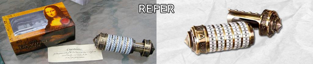

The word Cryptex is a neologism coined by the author Dan Brown for his NovelThe Da Vinci Code, denoting a portable vault used to hide secret messages. It is a word formed from Greekκρυπτός kryptós, "hidden, secret" and Latin codex "an apt title for this device" since it uses "the science of cryptology to protect information written on the contained scroll or codex".
The Cryptex featured in the novel The Da Vinci Code is described as a stone cylinder comprising "few doughnut-sized disks had been stacked and affixed to one another within a delicate brass framework", end caps make it impossible to see inside the hollow cylinder. Each of the disks is carved with the entire alphabet and can be rotated independently of the others to create different letter-alignment combinations.
The Cryptex works "much like a bicycle's combination lock" and if one arranges the disks to spell out the correct password, "the tumblers inside align, and the entire cylinder slides apart". In the inner compartment of the Cryptex, secret information can be hidden, written on a scroll of thin papyrus wrapped around a fragile vial of vinegar as a security measure. If one does not know the password but tries to open the Cryptex by force, the vial will break and the vinegar will dissolve the papyrus before it can be read.

Step 15: References
