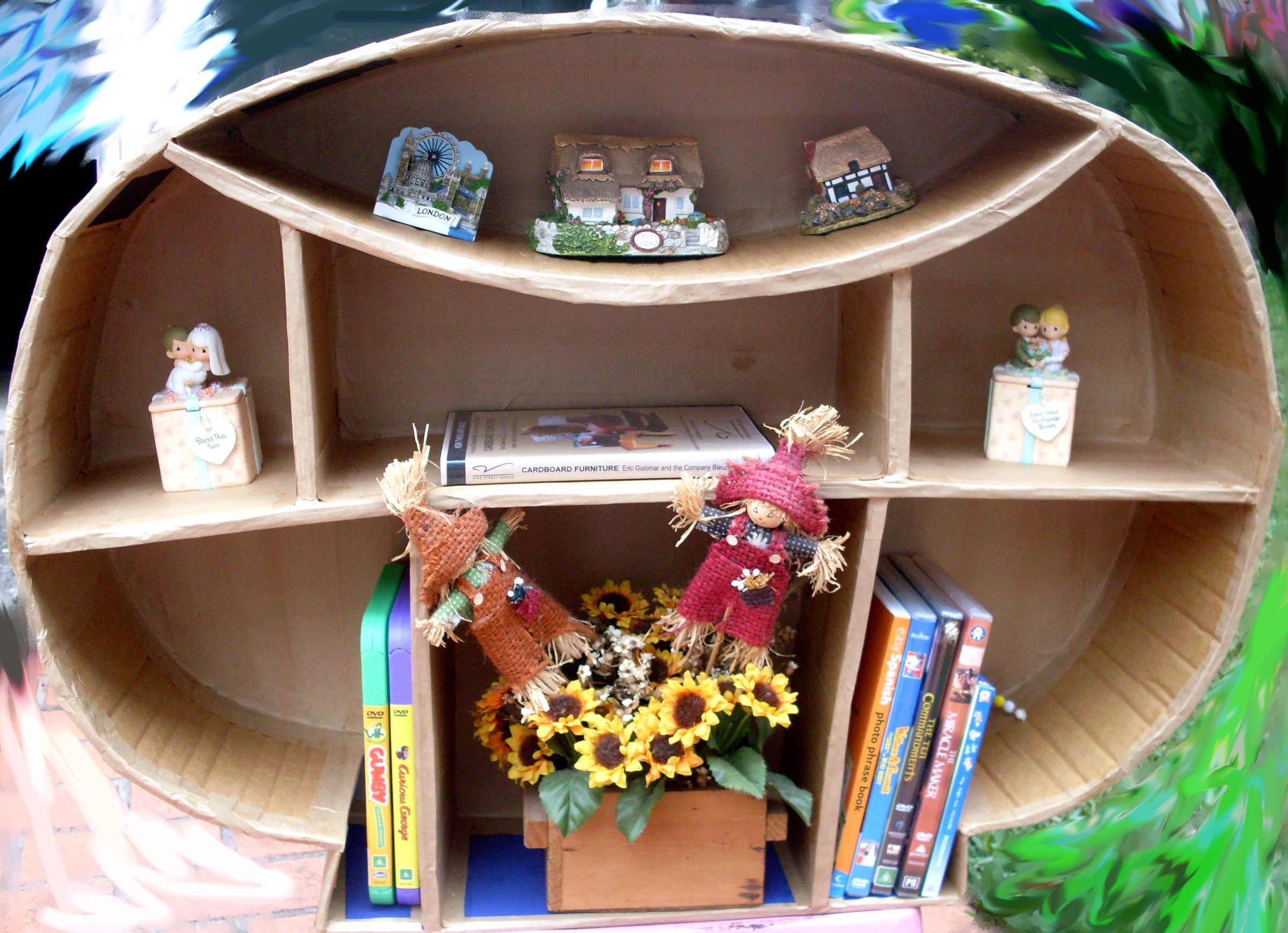

In this instructable, I demonstrate how I made an extremely sturdy three-storey book shelf made of six ply cardboard. Simply follow the same principles to create any design you like.

Step 2: 3 Silhouette Shapes
Now you will cut out the silhouette shapes.
Cut 3.
The middle one and the front one you will cut out the spaces for the shelves.
The 3rd silhouette will not be cut out inside as this is to be the BACK of the shelf.
In the pictures here, some like to cut 4 silhouette shapes for extra support.

Step 4: Layer Silhouettes on Top of Each Other
1. Place the uncut inside silhouette on the bottom level
2. Place the middle silhouette that has struts attached
3. Finally place the top level which will be the FRONT OF STRUCTURE
4. Put weights to add slight pressure so you can tape the pieces more tightly. I used coloured sand in zip lock bags.
A. Using very STICKY DUCT TAPE attach the stuts at the top, bottom, middle. This takes a while to do, but its relaxing exercise.

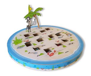

    Scriptone
    Scriptone
    Reply 3 years ago
    Hi I have an instructable for this one with video. The measurements depend on the longest pieces of cb you have at hand. I think I used a box for a fridge from the recycling bin outside the hardware furniture store.
    We need to check the 'grain' (way the inside tubes run) should be north to south for the strongest structure.
    AFter all the years of building the lovely the circular shaped one, it is still super strong. I made another version which I've not made an instructable yet, with doubled wall thickness.
    This was pretty durable even though I didn't paint it or cover it with tissue paper. Hope this helps you, feel free to ask any questions I'll try to help.
    https://www.instructables.com/id/Circular-Cardboard-Shadowbox-1/
