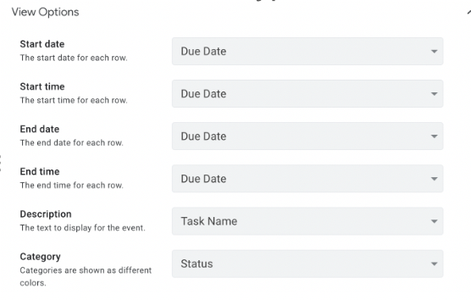

Step 3: Making the Calendar Function
  1. This step may be optional but it will make a calendar that allows you to see when your chores are do.
  2. Go to data and then slices and create a new slice
  3. Name it “Incomplete Slice”  and put [Status] = “incomplete” in the row filter condition bar
  4. Go to UX and make a new view called “Calendar” and press the calendar as view type and choose the “Incomplete Slice” as the box for “For this data”
  5. Go to view options and mark the boxes as seen on above:
  6. Go to display then the Icon and choose a calendar icon
  7. Then go to UX and then Ref views then go to the App detail and copy it
  8. Name the new copy Incomplete Detail and put “Incomplete Slice as the “For this data” box

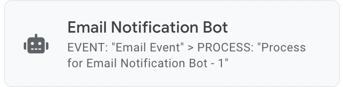

Step 4: Making the Email Notification Bot
This step is optional but it shows you how to make a bot that emails you the day before so that you know.
  1.  Go to the Automation and then Bots
  2. Make a new bot and call it “Email Notification Bot”
  3. Press “Configure event” and type in “Email Event”
  4. On the right of the screen, press the little gear symbol above your app, Press Schedule for Event Type, choose your app for the table.
  5. Press Daily for Schedule and put a desired time to email you.
  6. Turn on the switch below “ForEachRowInTable”
  7. For Filter Condition type in (TODAY()+1)=[Due Date]
  8. Add another step and enter “If [Status] is Incomplete
  9. Below that box change Run a Task to Branch on Condition
  10. For the box type in [Status] = “Incomplete”
  11. Then below the Yes add a task and search up send an email to the app user and tap it
  12. Then type in “Reminder!” in the Email subject
  13. The final step of the email bot is to type in “ You have <<[Task Name]>> due tomorrow!”
