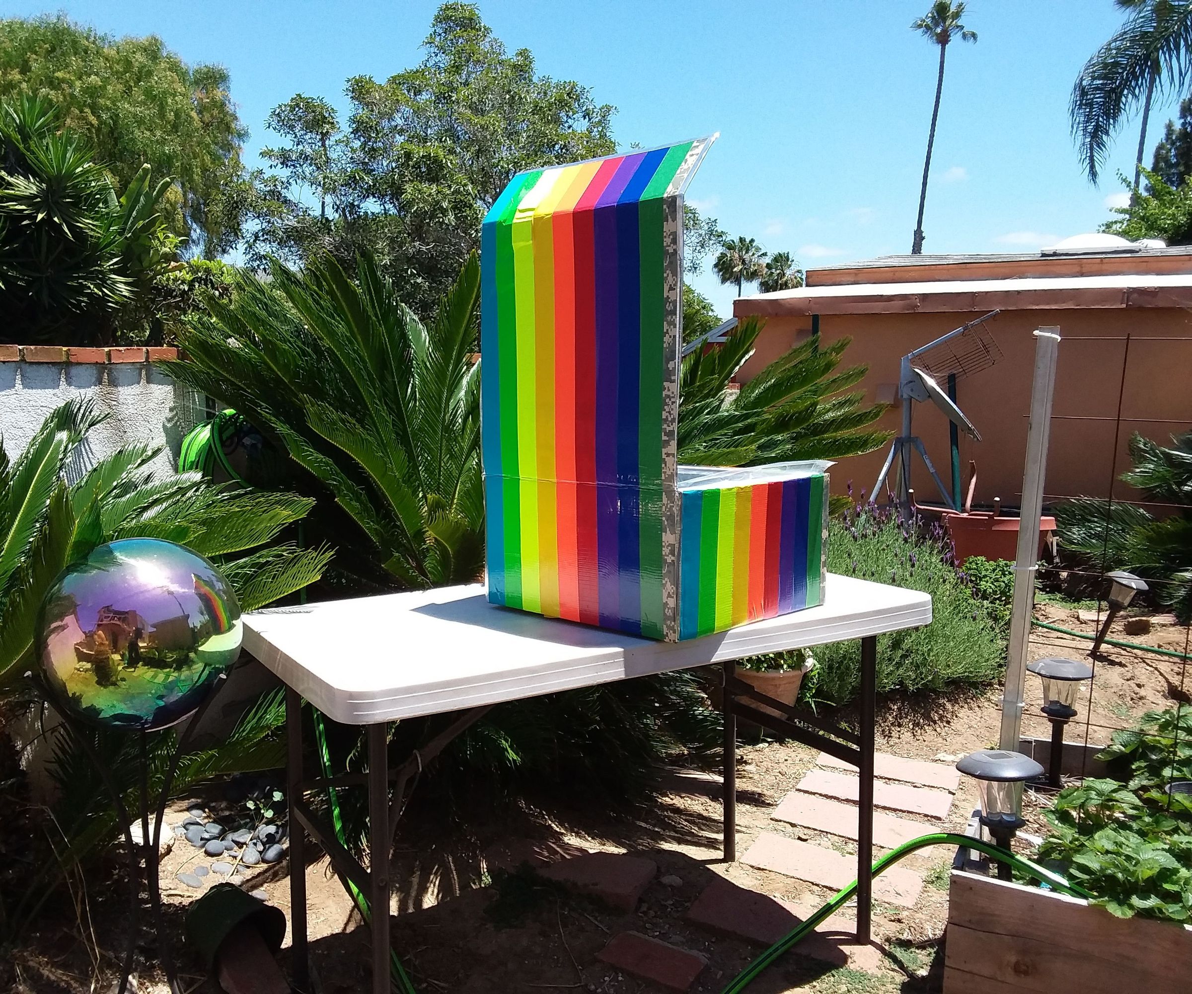

Step 7: To Cook With the "Beast" Copenhagen Solar Cooker Focus Sun on Center Base or Pot.
To cook with the "Beast" Copenhagen Solar Cooker you must adjust the panels with the clips to get the maximum amount of sun on the center base piece or pan you are using to cook with.
The reflected focus is so good in this picture that the wood appears to be made of reflector material but it is plain wood.
