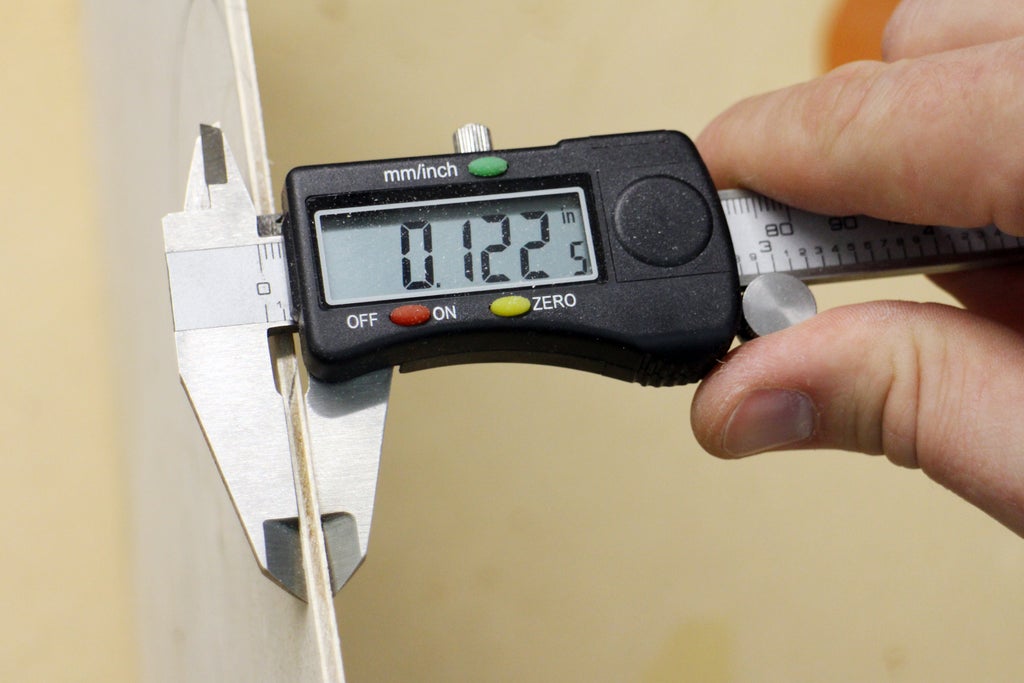

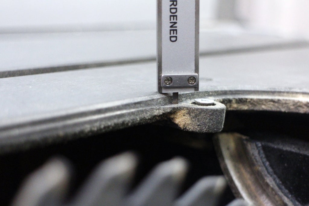

Step 1: Take Measurements of Insert
Remove your table saw insert and take the overall measurements: length, height, and depth.
![](https://content.instructables.com/FYW/59H2/IZYGESO8/FYW59H2IZYGESO8.jpg?auto=webp&fit=bounds&frame=1&height=1024&width=1024)
To get accurate readings I used digital calipers. Make sure your saw insert housing is clear of sawdust so you can get the best readings. Most saws have height adjustment screws so you can level out the insert after if your readings are a little off, but it's better to get accurate measurements before starting.

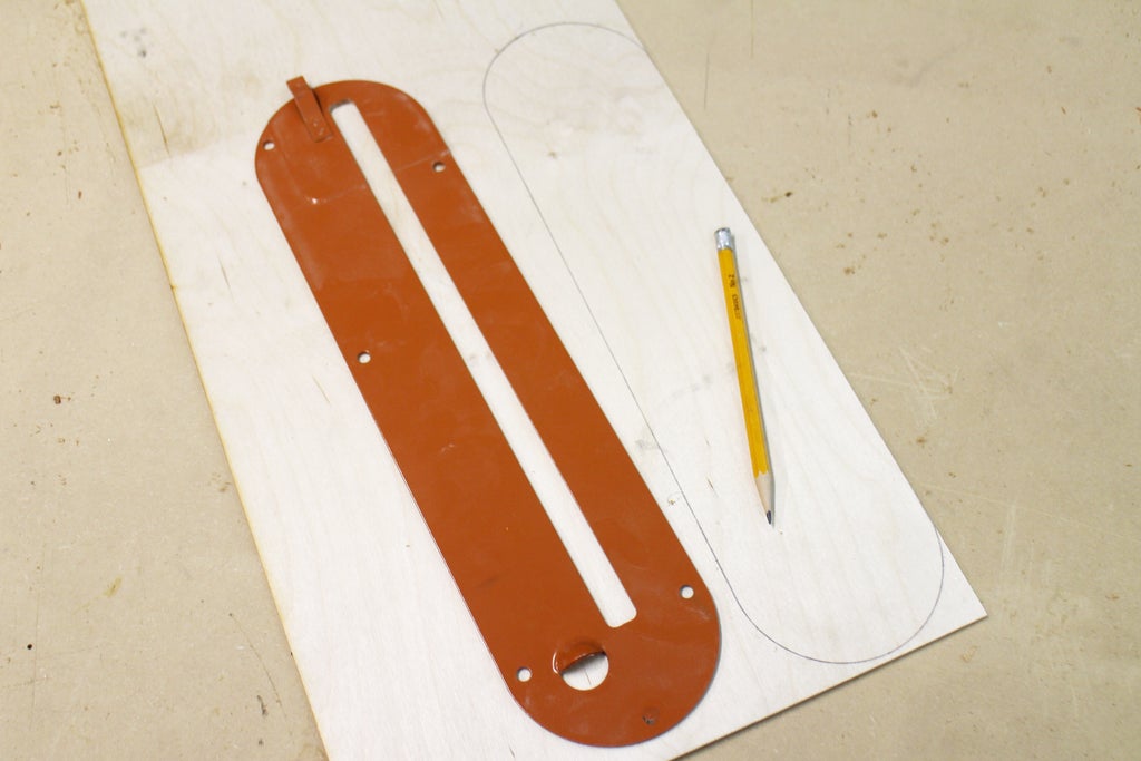

Step 2: Trace
The scrap plywood I sourced was roughly the same thickness as the existing insert, about ⅛". There are height adjustment screws in the insert housing that allow the insert to be raised and leveled a little, so as long as your scrap plywood is within this threshold you should be fine.
![](https://content.instructables.com/FR7/EJTQ/IZYGESS8/FR7EJTQIZYGESS8.jpg?auto=webp&fit=bounds&frame=1&height=1024&width=1024)
Place the stock insert face-down on the plywood and trace the outline with a pencil. There's no need to trace the blade slot, since we'll be cutting that out later.
![](https://content.instructables.com/FX7/GV2K/IZYGESNL/FX7GV2KIZYGESNL.jpg?auto=webp&fit=bounds&frame=1&height=1024&width=1024)

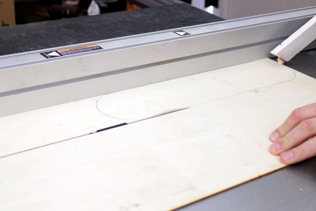

Step 3: Set Fence + Rip Cut to Width
Set your fence to the width of the insert, raise the blade only slightly higher than the plywood stock you're using, and then rip the plywood with the overall width.
![](https://content.instructables.com/FJX/0EK7/IZYGET0P/FJX0EK7IZYGET0P.jpg?auto=webp&fit=bounds&frame=1&height=1024&width=1024)
Setting a table saw fence accurately before you cut is critical to get accurate and consistent results on your table saw. Setting the fence is a topic covered in the free Table Saw Class - Meet Your Table Saw, check it out if you're unsure about your fence accuracy.

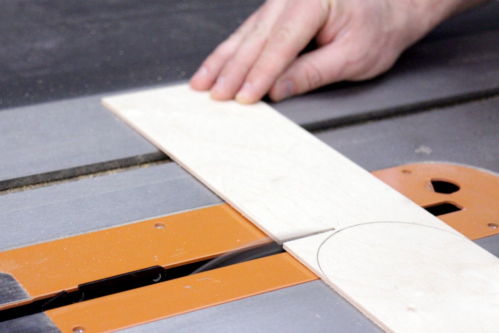

Step 4: Mitre Cut to Length
Once you have the plywood ripped to the right width it can be cut down to the right length.
Cutting long pieces on the table saw requires a mitre cut. Mitre cuts are made with the mitre gauge and need to have the fence moved away so it doesn't interfere while cutting.
![](https://content.instructables.com/FG6/C3KM/IZYGET1G/FG6C3KMIZYGET1G.jpg?auto=webp&fit=bounds&frame=1&height=1024&width=1024)
Set the mitre gauge to 0° and place the ripped stock against the back of the mitre gauge, lining the traced outline of the insert edge with the blade. The mitre cut doesn't need to be right on your trace line, since we'll be refining the cut by sanding in a later step. This mitre cut is just to trim down the length into something more manageable.
Use the mitre gauge to cut both ends of the plywood to trim up the outline.

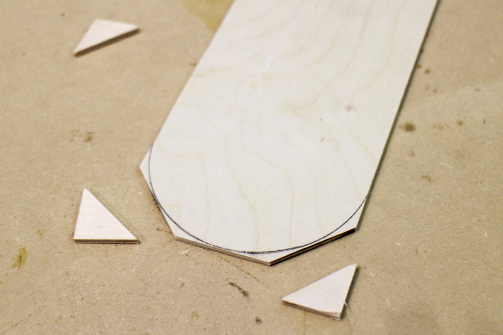

Step 5: Angled Mitre
To make the sanding process easier, material was removed from the corners of the plywood by making angled cuts on the mitre gauge - follow the link to learn how to make accurate angled mitre cuts.
![](https://content.instructables.com/F7T/TIHQ/IZYGET2V/F7TTIHQIZYGET2V.jpg?auto=webp&fit=bounds&frame=1&height=1024&width=1024)
The mitre gauge was set to 45° and the traced plywood was placed in the mitre gauge with the end to be cut trailing the mitre gauge. Corners were cut, and the mitre gauge was moved between the two mitre tracks so that every cut was trailing the mitre gauge and not leading it.

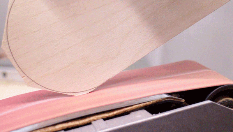

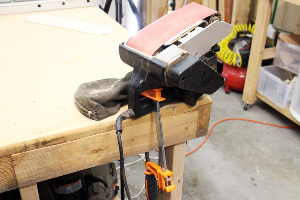

Step 6: Sanding
To round off the corners of the plywood a powered sander was used. Almost any type of sander can work for this application. Since I don't have a stationary sander I made do by inverting my belt sander and clamping it to the workbench.
![](https://content.instructables.com/F3T/QESL/IZYGET3D/F3TQESLIZYGET3D.jpg?auto=webp&fit=bounds&frame=1&height=1024&width=1024)
With the belt sander secured to the bench the trigger can be locked on and allow sanding with both hands without holding on the sander.
![](https://content.instructables.com/F9S/OA81/IZYGESM4/F9SOA81IZYGESM4.gif?auto=webp&fit=bounds&frame=0&height=1024&width=1024)

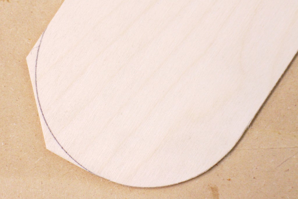

The corners of the plywood were sanded down right to the traced outline of the insert. Since the trace was alightly larger than the insert I knew I could sand very close.
![](https://content.instructables.com/FCN/SK7C/IZYGETBU/FCNSK7CIZYGETBU.jpg?auto=webp&fit=bounds&frame=1&height=1024&width=1024)
After power sanding I cleaned up any rough spots by hand sanding with fine grit sandpaper.

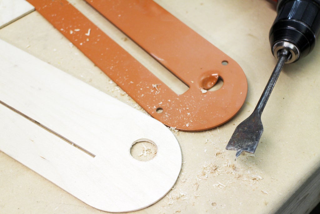

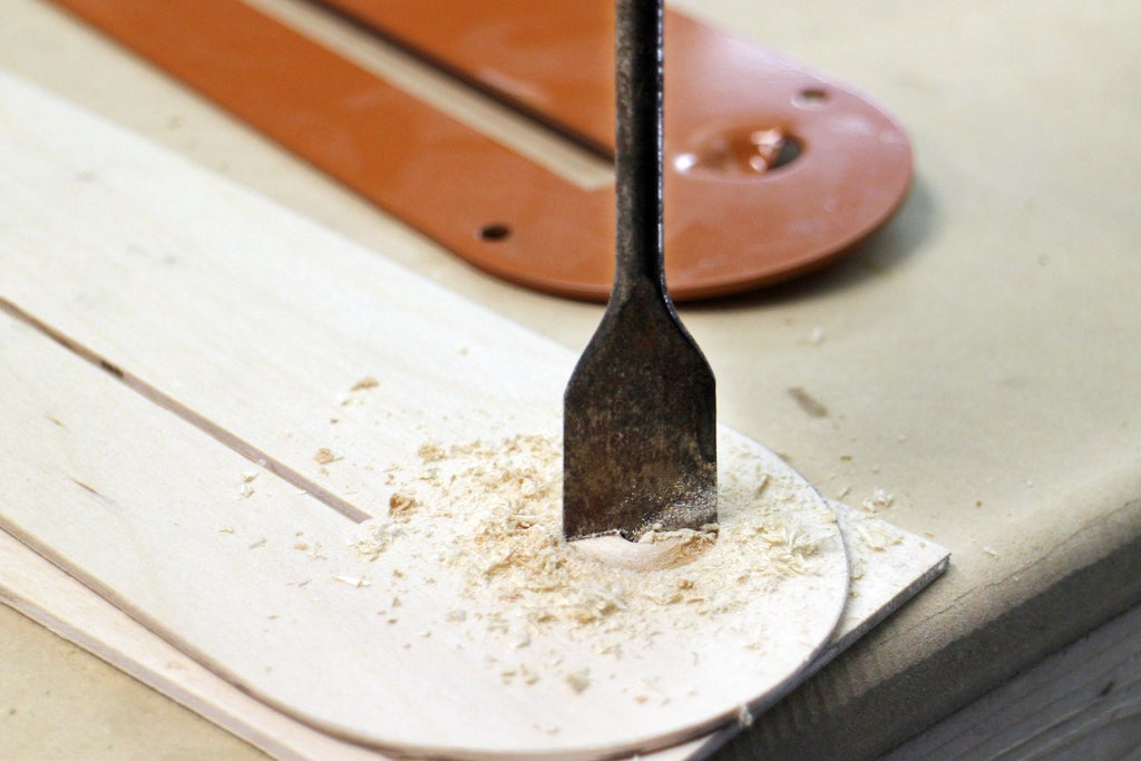

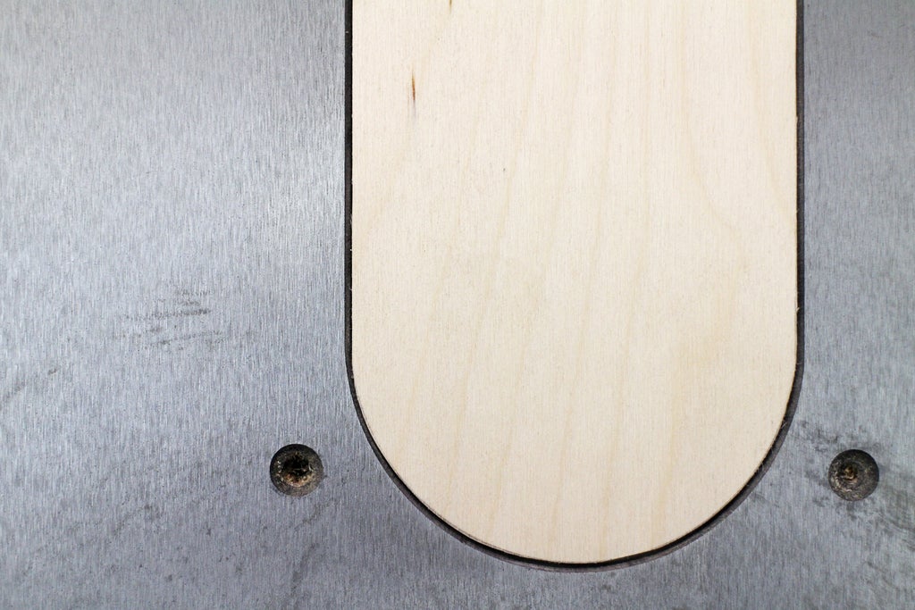

Step 9: Drilled Opening
To make the zero clearance insert easier to install and remove a finger hole can be drilled. Using the stock insert as a guide for placement, I drilled a ¾" hole in the plywood insert.
![](https://content.instructables.com/FUL/TD4M/IZYGETDG/FULTD4MIZYGETDG.jpg?auto=webp&fit=bounds&frame=1&height=1024&width=1024)
To reduce tearout I drilled the hole with a sacrificial board underneath the plywood insert.
![](https://content.instructables.com/FD9/AYHU/IZYGETDJ/FD9AYHUIZYGETDJ.jpg?auto=webp&fit=bounds&frame=1&height=1024&width=1024)
After drilling the opening the edges were smoothed out with sandpaper.

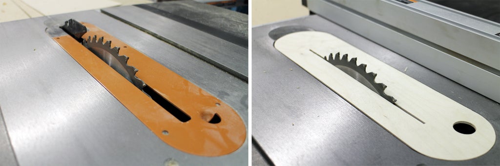

Step 10: Install

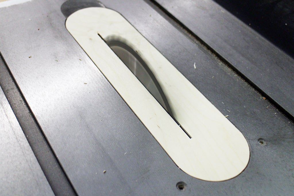

The zero clearance insert is ready to be installed and rip thin stock without fear of thin strips of wood being sucked into the saw.
Even though the zero clearance insert doesn't allow for sawdust to be extracted I still use the vacuum on my table saw as the suction pulls the zero clearance insert down into the saw and keeps the insert firmly in place. My stock insert has a clip on the underside that helps hold it in place, but this zero clearance insert doesn't require it when the vacuum is on.
![](https://content.instructables.com/FCX/3VUT/IZYGETDN/FCX3VUTIZYGETDN.jpg?auto=webp&fit=bounds&frame=1&height=1024&width=1024)
To keep the zero clearance insert operating as it should make sure the blade is of the saw perpendicular to the table, this will keep the clearance as minimal as possible and prevent any thin stock from being pulled into the saw.
