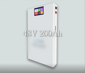

The Powerwall battery 48V 200Ah is the most commonly used specification in our daily lives. It is an integrated battery system that stores your solar energy for backup protection, so when the grid goes down your power stays on. Your system detects outages and automatically recharges with sunlight to keep your appliances running for days. With two or three powerwall batteries, we can get enough electricity from solar power for our daily consumption.

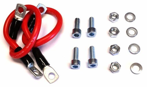

  • Connectors (About 16 pieces)
  • Others: EVA cotton, screws, ribbon cables, plastic pipes, etc.

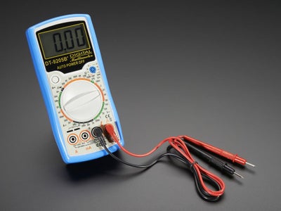

  • Multimeter

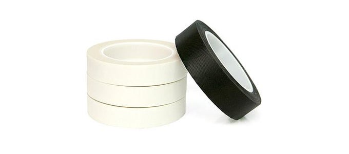

EVA cotton can protect our LiFePO4 battery cells, which are shockproof, fireproof, and insulated. Cut two EVA cotton into suitable sizes and tape them on the battery shell.

  • First, we should check the voltage of each battery to ensure consistency.

Step 7: Put the Epoxy Board Between the Batteries
Put the epoxy resin board insulation board between the battery packs. The epoxy board is suitable for the protection and bonding of the LiFePO4 battery.
Step 8: Fill EVA Cotton to the Batteries
(EVA cotton can be shockproof, fireproof, and insulated)

Step 21: Install the Monitor to the Cap
Battery monitor, indicating the state of charge percentage and more data. We can install it to the cap.
Step 22: Connect the Monitor to the BMS
This is the final step of the assembly process. After connecting the monitor to the BMS, the battery is ready for working.
