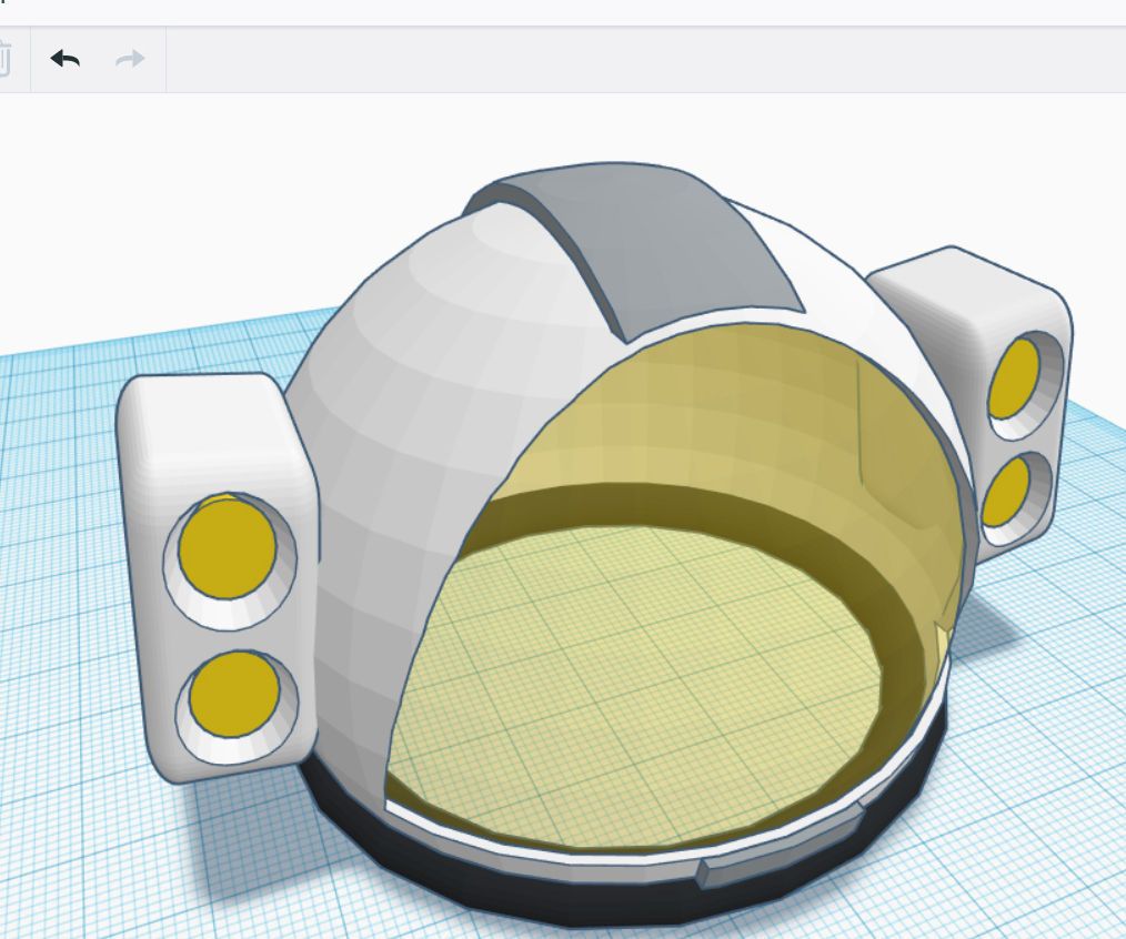

Use the library and find the round roof shape and drag it onto the workplane. Place the rounded roof shape partially inside the habitat and then stretch the shape outwards to make a tunnel shape.
![](https://content.instructables.com/FVQ/L8TB/K24MO98K/FVQL8TBK24MO98K.LARGE.jpg)
Because we can see inside the habitat I combined a few simple shapes and moved them together. This is your chance to make your own small creation to put inside your habitat.
![](https://content.instructables.com/FOE/2LM8/K24MO98L/FOE2LM8K24MO98L.LARGE.jpg)
Here the shapes are put inside the habitat.
