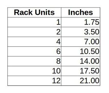

Height Calculation and Estimation
Using a spreadsheet like Google Sheets or Libre Office Calc makes this simple, because you can try out a number of different combinations and configurations
To calculate your cart height, use the following formula:
(3 * Plywood Thickness) + RackUnit Height + Caster Height + 1/8"
Be sure to use the actual plywood thickness and not the nominal dimensions. 3/4" plywood is not 3/4" thick!
