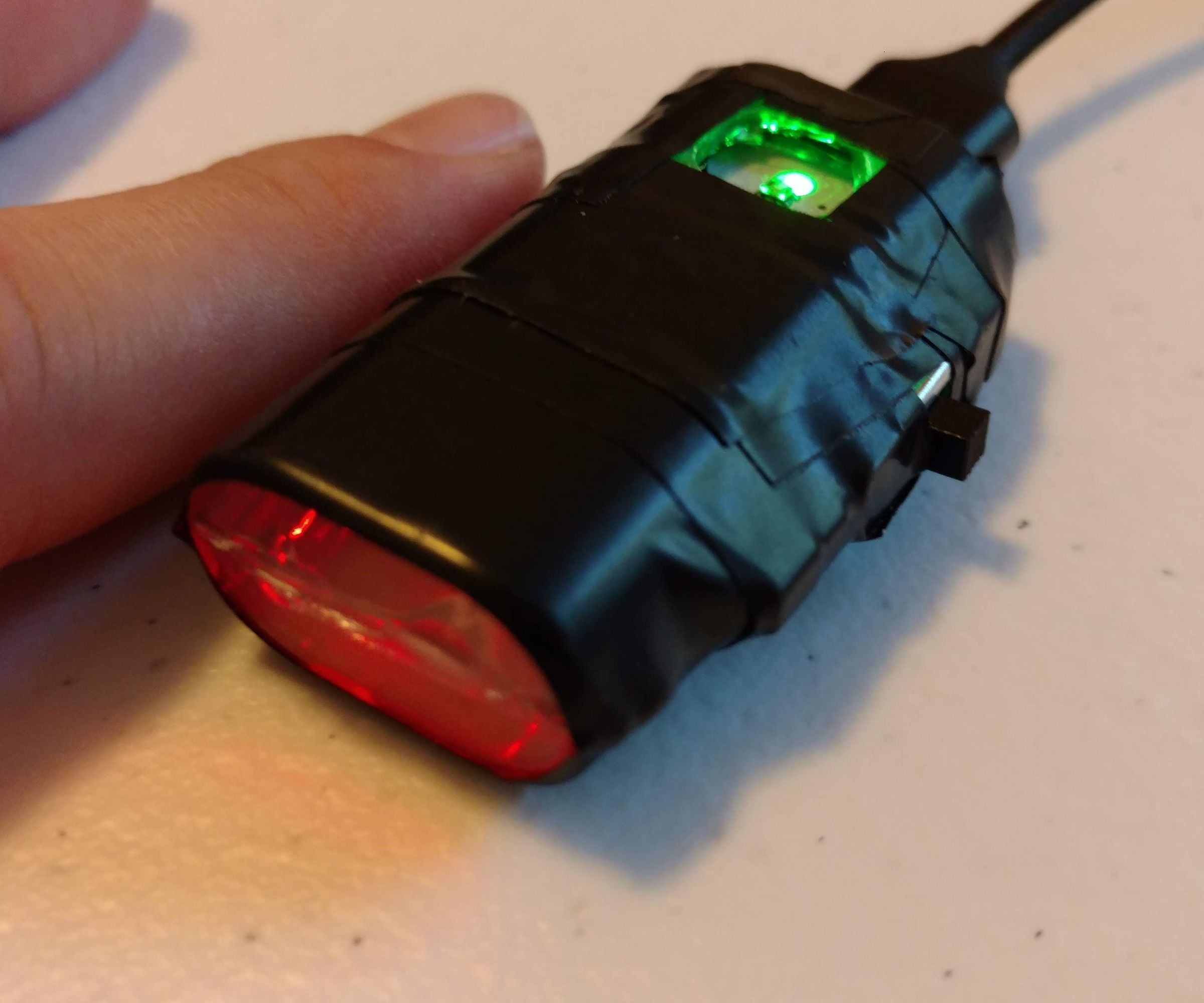

Introduction: EASY Rubber Duckies With Digispark & DuckyTrainer
In this tutorial you will learn how to setup a USB Rubber Ducky (USB Keystroke Injector) WITHOUT coding!
What is a USB Rubber Ducky?
● USB Device that automatically imitates a human user when connected.
● Much faster than a human, no typographical errors. Most screen interaction can be done without a mouse by using TAB and ARROW keys.
● Useful for benevolent IT productivity purposes in addition to black hat uses.
● Similar to a portable macro but runs without needing to install or execute the macro on the target computer. The computer just thinks it is a human typing on a USB keyboard.
