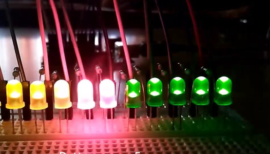

Step 2: Wiring the External LED
  1. Connect the anode (+) of the external LED to the configured GPIO pin on the Black Pill board.
  2. Connect the cathode (-) of the LED to ground (GND) on the Black Pill board.
  3. Optionally, insert a resistor between the GPIO pin and the LED to limit the current if necessary.

Step 4: Testing
  • Power on the STM32 Black Pill board.
  • The LED should start blinking at a 1-second interval.
Conclusion:- The STM32 Black Pill is successfully set up and programmed to blink the external LED using HAL Programming.
