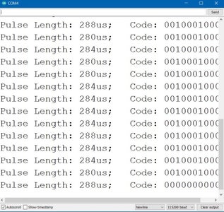

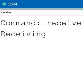

Step 3: Reading Code From Your Remote
If you wish to read the code from your existing remote, type "receive" into the serial monitor and hit enter. The program will reply with the "Receiving" line, after which every time you press the button on your remote, the board will display the sync pulse length and the read code from your remote. You can save this code for other purposes or copy it to edit.

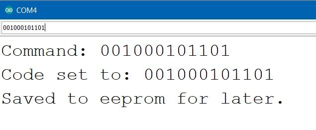

Step 4: Editing and Changing the Code to Transmit
If you want to edit and change your existing code, you can just copy or write one in the serial monitor. The program will set it as active and will also save it into EEPROM, so it will stay in memory even after a reset or power off. If you only copy the code from your remote, it will be able to emulate your remote once powered on again.

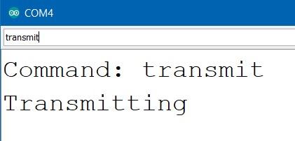

Step 5: Transmitting Custom Code
Once you edit or copy the desired code, just type "transmit" in the serial monitor and the program will start to transmit the saved code continuously. Set the board to transmit and the next time you power on the microcontroller, it will transmit by default with the code that was saved in EEPROM.

Receiving
To get the data bits from your existing remote, the program needs to lock onto the signal first. The way it can achieve that is by listening to the silence before each cycle of bits. While in receiving mode, the program constantly checks the state of the receiver radio. While there is no remote signal present, the output of the radio module is just noise of ones and zeros. Once there is a signal coming from the remote, there will be a clear pattern detectable. Once there is a high pulse coming, the program checks the length of the previous low period and if it is sufficiently long, the program will begin its reading function. Firstly it measures the first third of the first bit to measure the length of the start pulse. As per the spec, it has to be 310us long, so if it deviates from that value too much (in this case 50us) then the program will declare it as a bad signal and halt reading. If everything is in spec, it will cycle twelve times reading the third third of each bit signal. Every time a bit has been read, the value is stored in memory to be displayed on the serial monitor.

In the case of transmitting signals, the steps are pretty much the same as with receiving but the other way around. Following the spec, the program will generate a 310us high and then a 310us low pulse before every data bit. This will form the High-Low-Data pulse series. after twelve cycles of data bits, there is a single 310us-long high pulse before the 12ms-long silence period. The transmission continues until the program has not received another command via the serial port.
Storing values
To enable the possibility to clone a remote, the microcontroller has to store the code in nonvolatile memory. The GlowDuino board used in this project has built-in EEPROM for such things and it will be able to store the set code for later use. To do this the EEPROM.h library has to be included, which will enable the use of the eeprom.read() and eeprom.write() functions. With this, every time there is a new code to be transmitted, the program will also save it into EEPROM so the next time the circuit is powered on, it will be able to load that at the setup phase.
Similarly to the code, it is also necessary to store the state of the cloner in EEPROM. This will enable the user to have the cloner set to a specific code and mode and still be able to use the circuit without a serial connection.
