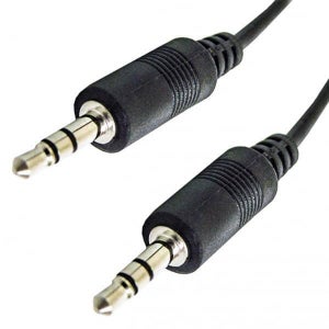

-An aux cable to connect the circuit to a source:
https://amz.run/6QMI

No matter where you get your audio connectors, you need to determine the pinout of the connectors. On a 3pin audio jack, the pinout is as follows:
The tip is the Left Channel
The middle ring is the Right Channel
The sleeve of the connector is the Ground
At this point is a good idea to use jumper wires that can be directly connected to the microcontroller. I soldered my wires to a jack connector on one side and left the pins at the other end, but you can also get connectors where soldering is not required. A link for that is above in the supply list.
