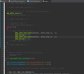

Step 7: Goto While(1) in Main() and Add Your Code
Used GPIO Pin number 13 you can use other GPIO Pins
HAL_GPIO_WritePin(GPIOC, GPIO_PIN_13, 1);
HAL_Delay(5000);
HAL_GPIO_WritePin(GPIOC, GPIO_PIN_13, 0);
HAL_Delay(5000);

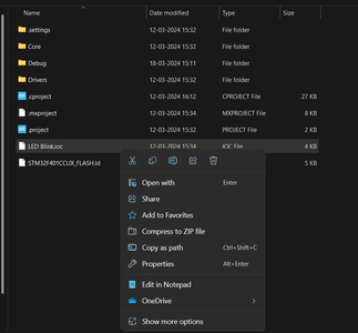

Step 9: Copy the Path Of.elf File
To copy the path of your project's .ioc file in STM32CubeIDE:
1. Find the .ioc file:
  • Look for it in the Project Explorer window (left side) under your project name.
2. Right-click and copy:
  • Right-click the .ioc file and choose "Copy Path" (or similar).
This copies the entire file location for pasting elsewhere.

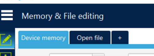

Step 10: Open STMCubeProgrammer and Connect to STM Board Via USB
Step 11: Click on Open File and Paste the Copied Path
Step 12: Go to Download Options (Found in Toolbar on the Left)
Step 13: Configure Download Settings and Activate Automatic Downloads
