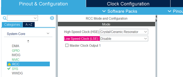

Step 2: Now Configure Your STMcubeIDE

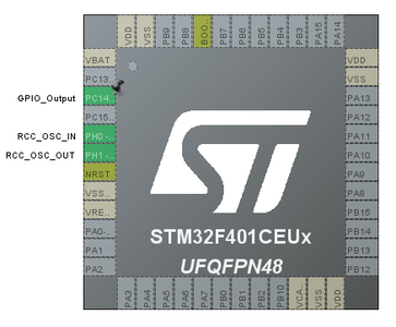

Step 3: Selection of Modes for Pins
Step 4: Pinout & Clock Configuration

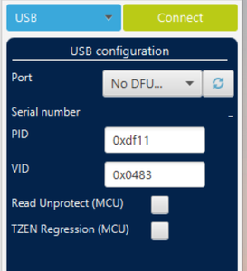

Step 7: Connect STM32 Using USB

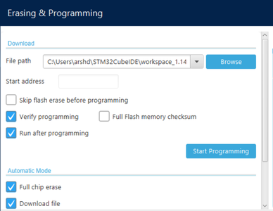

Step 8: Click on Download Option
Step 9: Select Start Automatic Mode
