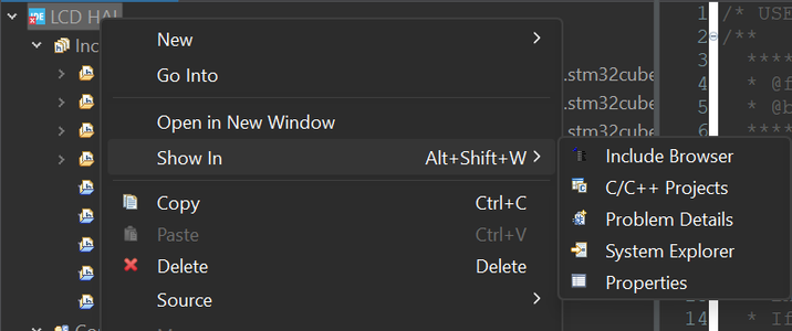

Step 8: Opening the .elf File Created in System Explorer
Now obtain the path of your project.

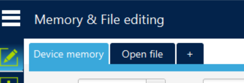

Step 9: Upload the Code to STM32 Black Pill
Step 10: Click on Open File and Paste the Copied Path
Step 11: Go to Download Options
Step 12: Change Download Options and Click on "Start Automatic Mode"
