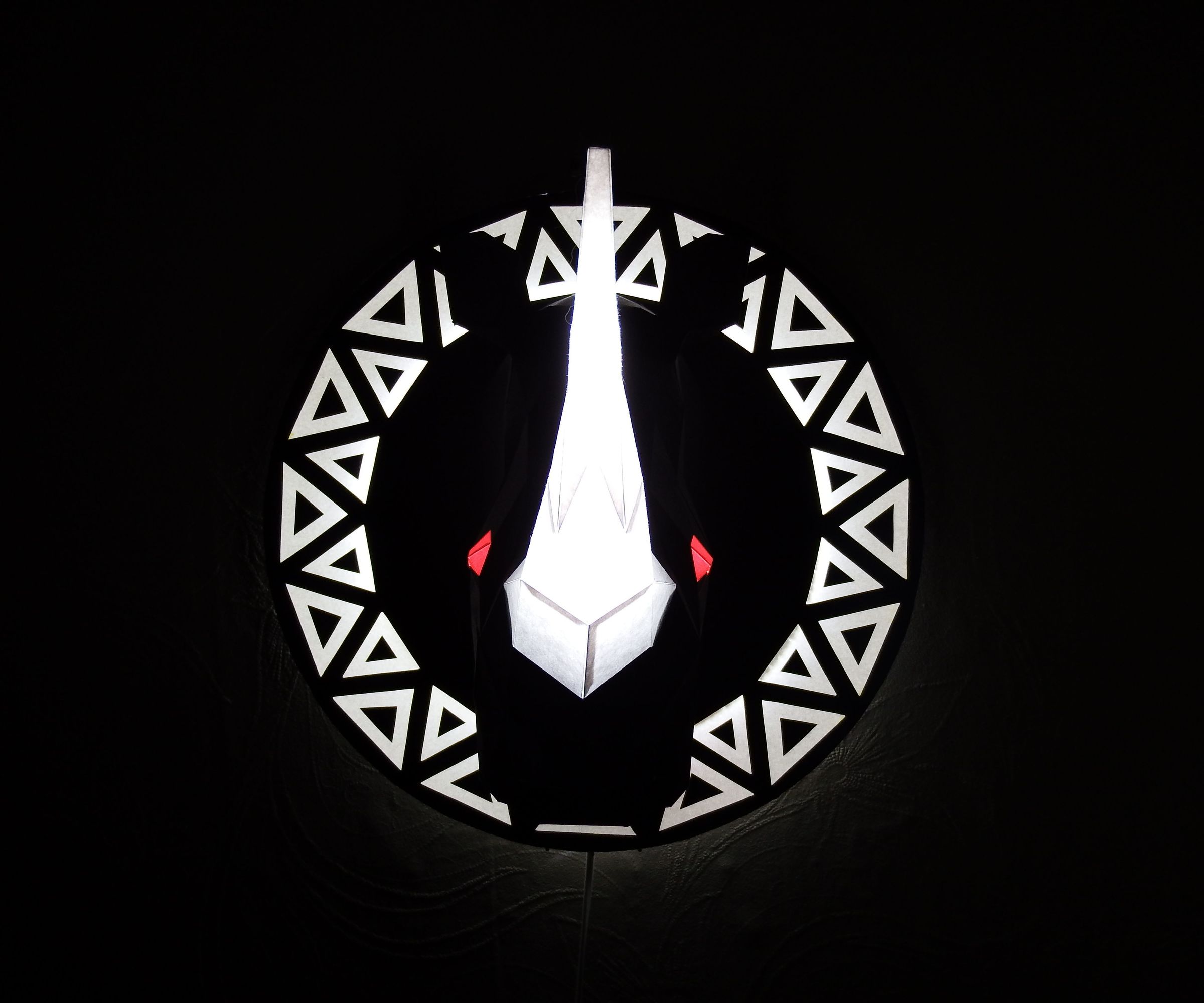

On the reverse side of the assembled unit, an aluminum profile was glued along the edge and an LED strip stuck onto it. Aluminum profile was used to remove heat from the LED strip. To achieve the color gradient, an LED strip of blue and white was used.
Step 9: Body Manufacturing
The lamp body is made of plywood to the size of the image, taking into account the overlaps for the location of batteries, microcircuits and other things. The back cover is attached to the case with 4 screws. The case is ground, covered with black paint and varnish.
Step 10: Electrical Circuit Assembly
An 18650 battery is used to power the LED strip, and to charge it, the microcircuit is controlled from overcharging and a micro USB connector. A voltage converter was used to power the LED strip, which converted the 3.7 volt battery into 12 volts necessary for its operation. This converter is not designed for long pieces of LED tape, but it will be enough for this job. To turn on / off the backlight switch was used. All elements were assembled as follows.
Step 11: Final Assembly
The final assembly includes the insertion of the main unit of the image, the final assembly of the electrical circuit, its verification and installation of the back cover. My camera doesn't quite convey colors. Live looks better.
Step 12: Final Result
The work is done. Thanks for attention!
