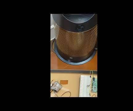

This is a timer to check your handwashing time, additionally, noticing the customer with sound and LED lights signals. When your hands get close to the ultrasonic sensor, the blue light changes to red, and the speaker makes a sound; until the time has last over 20 seconds, the LED light changes into color green, and so does the speaker make two short voices; which means the 20 seconds has past and it is probable to start to dry your heads(hand washing is done). After drying the hands, press the button for the green LED to darken, leads the handwashing routine to end.

Step 2: Set Up the Wires and Pins
Follow the figure to insert wires onto the Arduino board.
Step 3: Pack Up Your Arduino Wires and Decorate
Pack up wires in order to prevent water from getting contact with wires and boards.
