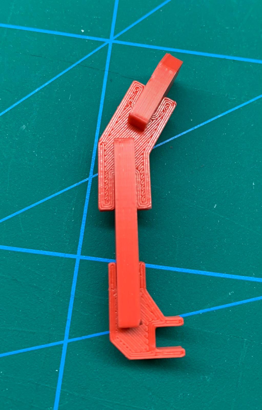

Step 4: 3D Printing: Slicing
I used Cura as my slicing software - you can use any other software you like!
I used PLA filament with an Ender 3-v2 printer. Here are my settings:
20% infill
0.4mm nozzle
400°F nozzle
Repeat the prints for each finger
The STL files are attached:
