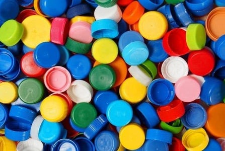

Step 2: Sorting Out
I collected 40 bottle caps that are a mixture of red and white ones. I chose these 2 colours for a marbling effect - any colour works as well! (As long as they are of the same material, I used HDPE for this)
You can check the material of the caps on the inside - it is usually stated

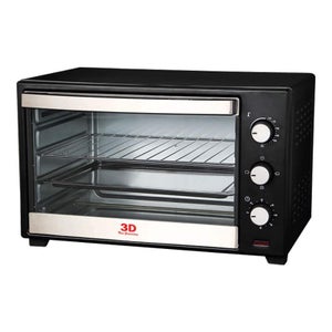

Step 4: Heating the Mould
Put the mould into an oven to heat it at the same temperature as the heat press so that it does not cool down as quickly when added to the mould.
