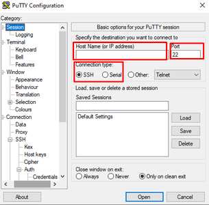

Step 3: Connect With PuTTY
Open PuTTY on your Windows system.
In the PuTTY configuration window, enter the IPv6 address of your Ubuntu VM in the "HostName" field.
Set the connection type to SSH and port to 22.

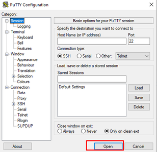

Step 4: Start the Connection
To begin the connection, in PuTTY, click the "Open" button.
PuTTY will prompt you enter username and password for your Ubuntu VM.
