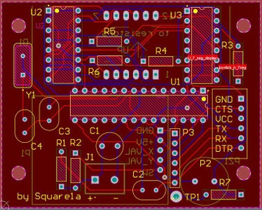

Most of the components are soldered onto the PCB, so you can see most of them in the photos above. I have attached a complete list of supplies as a PDF below.
Step 1: Make the PCB and 3D Prints
This project shares the same PCB design and 3D prints as: https://www.instructables.com/How-to-Display-and-Set-Numbers-With-7-Segment-Disp/, which uses the PCB for a timer. The two projects are related and demonstrates the versatility and adaptability of the design. The Arduino code for the voltmeter and battery tester is different to the timer, and is attached under Step 4.
There are some differences between the projects. For the battery tester, solder a 330Ω resistor for R7; for a voltmeter solder a very large resistor (e.g. 1MΩ) for R7. A good voltmeter does not draw much current from the circuit being tested, so its resistor (R7) needs to be large. By drawing a minuscule current, the voltmeter does not interfere with the circuit's performance. When testing a battery, you want to test it at certain load current. A typical rechargeable AA battery has 1.2V, so the current equals 1.2V / 330Ω = 0.0036A. Testing the battery at 3.6mA is more accurate than testing at some nano-amperes of current.
For both the voltmeter and battery tester, solder a wire to TP1 and a separate wire to pin 1 of P3 (which is GND) (see the blue and yellow wires in the photo above). The wire will be used to make contact with the two terminals of the battery or where the voltage is measured.

Step 5: Multi-purpose PCB
The PCB used in this project is designed to be versatile and adaptable. In this Instructables, the PCB is used for a voltmeter/battery tester. As you have already seen, the PCB can also be used for a timer. In a future Instuctable, I will show how it can be used as a bluetooth remote control for a robot car.
