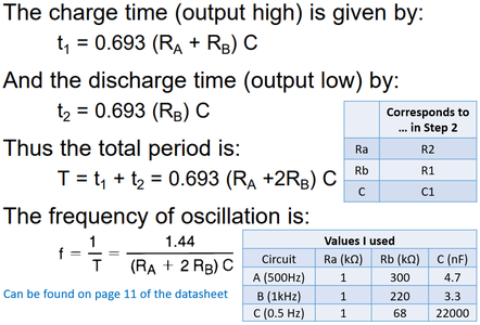

The equations in the picture above are from the 555 timer datasheet (as attached under Step 2). In my design, I want the charge time to have (as close to) the same duration as discharge time, so I want resistance, Ra, to be as small as possible. I used the minimum recommended value for Ra, which is 1 kΩ.
In my design I want to produce 500 Hz and 1 kHz sounds. Each sound plays for 1 second, so the period of Circuit C is 2 seconds, meaning its frequency is 0.5 Hz. I set Rato 1 kΩ. By substituting Ra and frequency into the fourth equation above, capacitance (C) and Rb are found.
I listed the values of all the capacitors I have, substituted these values into the fourth equation to find the theoretical value for Rb. I picked the capacitor-resistor pair that has the theoretical value for Rb closest to the value of the resistor I have. These calculations can be repetitive, so I used Excel to automate the calculations, a bit like in: https://www.youtube.com/watch?v=qqU2xllewk4&ab_channel=Microsoft365
The values I used for the capacitors and resistors are shown in the picture above.
