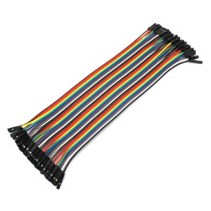

2.Female to Female Jumper Wires

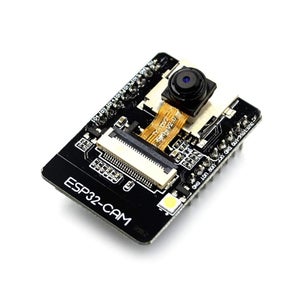

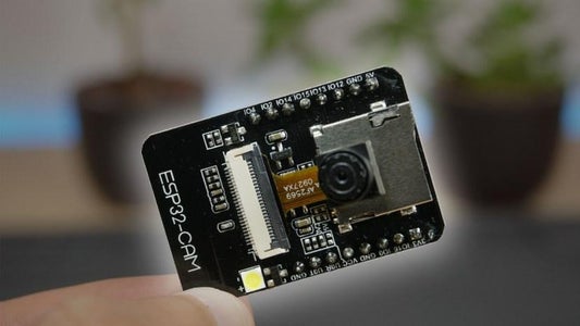

Step 1: Introduction to the ESP32 CAM
The ESP32 CAM is one of the family of ESP32.Its by far the most exciting to work with, as it has various features like Face Recognition, SD memory card, etc.It does have pros and cons, though, and I'll list them here:-
Pros
1.The camera is very cheap, and is jam-packed with features for its price.
2.Features bright LED, useful for working in dark conditions.
3.Features SD memory card slot, used for storing footage.
Cons
1.Does not have USB port for programming, makes a huge pain to program.
2.Camera quality is not that good, even at highest resolution.
3.Makes it hard to attach external antennae without removing tiny components.

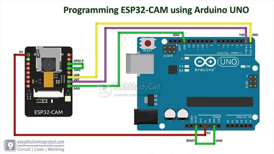

Step 3: ESP32 Circuit
Attach everything according to the pictures.Select the right board!

4.Connect the circuit to your computer using the USB cable.
5.See where I have given some fake Wifi credentials.Change it with your own.
6.Click Upload
After its finished, disconnect the the wire connecting the jumper U01 to GND on the ESP32 CAM.
Connect the circuit back to the computer and you should see a message containing a IP address in the Serial Monitor.
