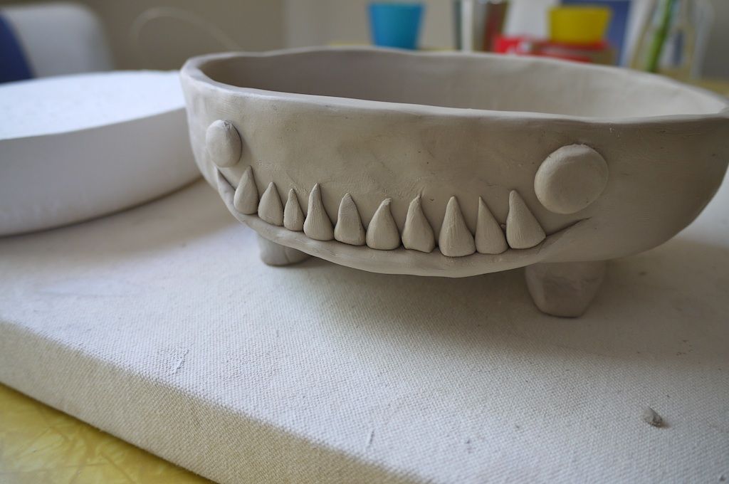

Introduction: How to Make a Hump Mold for Ceramic Hand Building
The hump mold is a great way to make bowls without using a pottery wheel or using the pinch-pot method. The molds are super super easy to make and well worth the time.
