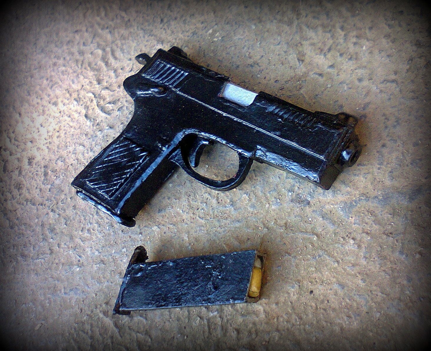

I can't stress this enough: Blueprints and Reference Image are ESSENTIAL. In this case I made one of the two pistols used by Dante in the Devil May Cry Series, in this case, Ebony, the black one, which he holds in the right hand.

Here, I recommend you taking a piece of plastic or whatever material you feel confortable working with, and make things like the Trigger, Trigger Guard, Hammer, and Sights, also, note, if you're making the same guns as I am, Ebony have a normal Hammer and Straight Sights, while Ivory have a Round Hammer and "Rounded" sights!

Now apply your base paint, wait to dry, then mask all the details and use your other color as you wish! Not shown in the photo, but the black one got some wood laquer on the handle.

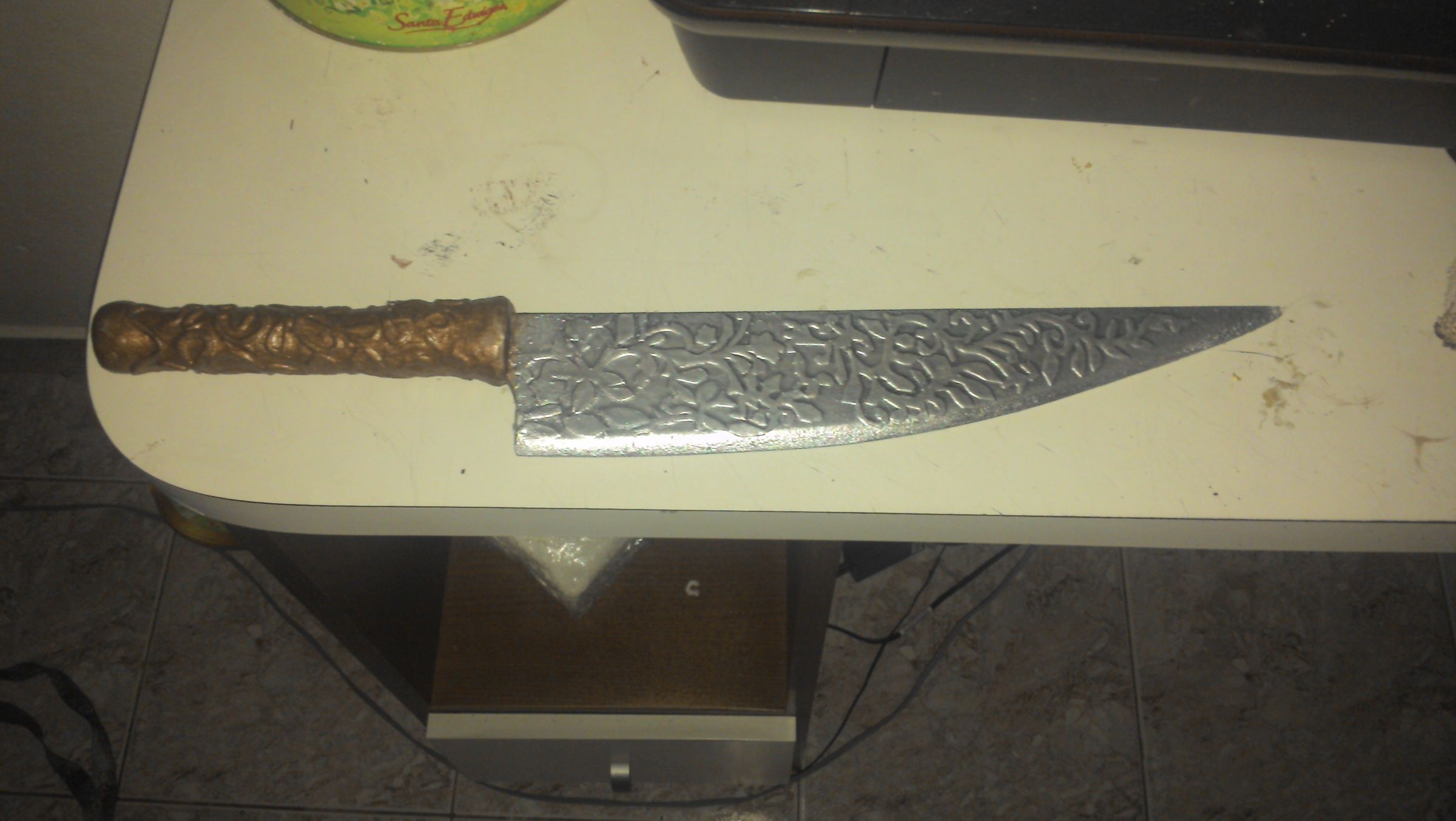

Now you've finished your prop pistols! You can also use this tutorial to make other types of weapons, like the Knife on the photo! Be happy, go cosplay!
