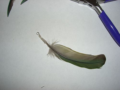

This is a relatively simple way to wrap wire around the shaft of a feather to make it easy to add to a piece of jewelry.
You will wrap wire around the feather shaft as well as part of the wire, which creates a nice tight wrap that prevents the feather from falling out.

Step 2: Form the Hanging Loop
Decide how much of the feather shaft you want wrapped with wire, and use the round-nose pliers to make a loop that far down the wire. By wrapping wire around the feather AND part of the wire, you will have a firmly wrapped feather that won't fall out of the final coils of wire.
I recommend at least 1/4 of an inch to maybe half an inch; beyond that, it is an aesthetic decision: do you want a lot of wire, or only a little? Longer feathers might need more shaft wrapped in order to look right, even if they don't need that much for purely structural reasons.
After wrapping the wire once around the pliers, bend the long end of the wire back in the direction it came from, so it wraps around the short end (photos 4 & 5). This will make it easier to start wrapping the long end of wire around the feather in the next step. There should be a bit of a gap where the long wire crosses over the short one; you will insert the tip of the feather shaft into that gap.
You want the short end to be sticking out straight from the loop, as shown in the photo, so that the feather will hang straight down. Small gauge wire is easy to bend, however, so if things aren't completely straight when you end, you can adjust it when you are done with the wrapping.
In the example shown, this was a tiny feather (I do not recommend using a tiny feather for your first try; it is hard to hold onto), so I wanted to have almost as much straight wire held against the feather as there was bare feather shaft.
Step 3: Wrap the Wire Around the Feather
Cut the wire free from the spool (unless you are better at planning than I am, and cut out 4 or so inches already). The long end of the wire needs to be about 2-3 inches to wrap around the feather shaft.
Insert the tip of the feather shaft into the gap at the base of the loop, with the short end of the wire against the shaft (cut end pointing toward the body of the feather).
Grasp the feather and short wire together tightly. I used my fingers, but you may find pliers easier. (With a larger feather, pliers would be easier; I wasn't quite coordinated enough to manage slippery wire, small feather, and pliers.)
The shaft of the feather will probably be thicker than the wire, so grabbing both with the pliers can be tricky because when the feather is held, the wire is not, and it will tend to fall free - you have to really pinch hard, which will tend to squash the feather shaft so it is the same thickness as the wire - but that's okay! You won't see any resulting damage when it's done!
Wrap the long end of the wire firmly around and around the feather shaft until you have covered the short end of the wire. Firm loops of wire will basically squash the feather shaft against that short piece of wire, and hold everything together.
You can either continue wrapping the feather with wire if you want the look, or cut it off.
Step 4: Add Feather to Jewelry
Use the loop at the end of the feather to hang your wire wrapped feather from an ear wire, or a jump ring (useful for adding it to a necklace), or anything else you want to hang it from.

I was wondering though is there a nice way of hiding the cut end of the wire at the end of the coil? Mine seems to stick out and when I try to take my pliers and "tuck" it in there's no where to tuck it.
Thanks again for this awesome tut :)
0
jfeathersmith
jfeathersmith
Reply 10 years ago on Introduction
You might be able to put a really sharp bend into the end of the wire, and kind of smash/crimp that into the coil so that the end is hidden. I usually just crimp the very end really tightly so the end doesn't poke out - and cut it at the right spot first so that the cut end is not on the visible side! Filing the wire end before you tuck/crimp it will also reduce the risk of hurting someone.
I suppose you could always cut a little scrap of fabric or ribbon or something and glue it over the end of the coil, too.
