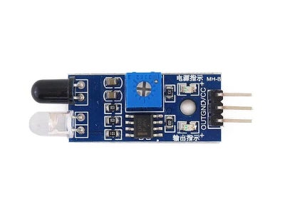

Step 1: About IR Obstacle Avoidance Sensor
The infrared (IR) obstacle sensor is used to detect the presence of any obstacle in front of the sensor module by using the infrared signal. The detection range is from 2cm to 30cm. The detection range can be adjusted by a built-in potentiometer.
Step 2: Pinout
IR obstacle avoidance sensor includes three pins:
GND pin: needs to be connected to GND (0V)
·       VCC pin: needs to be connected to VCC (5V or 3.3v)
·       OUT pin: is an output pin: LOW when there is an obstacle, HIGH when there is no obstacle. This pin needs to be connected to Arduino's input pin.
Step 3: How It Works?
An infrared obstacle sensor module has a built-in IR transmitter and IR receiver. The IR transmitter emits the IR signal. The IR receiver looks for the reflected IR signal to determine if the object is present or not. The presence of obstacle is reflected in the OUT pin:
·       If the obstacle is present in front of the sensor, the sensor's OUT pin is LOW
·       If the obstacle is NOT present in front of the sensor, the sensor's OUT pin is HIGH

Connections are given as follow:
Gnd pin :gnd
Vcc pin:5V
Out pin:2

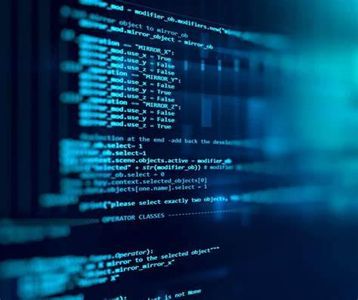

const int SENSOR_PIN = 2;
void setup() {
 Serial.begin(9600);
 pinMode(SENSOR_PIN, INPUT);
void loop() {
 int state = digitalRead(SENSOR_PIN);
 if (state == LOW)
   Serial.println("The obstacle is present");
 else
   Serial.println("The obstacle is NOT present");
 delay(100);
code avilable at git hub : https://github.com/Madhankarthick/interfacing-obstacle-sensor-with-bharat-pii/blob/96f32390d50358ae4340e85fdccf67f15a61526a/obstacle%20sensor.txt
