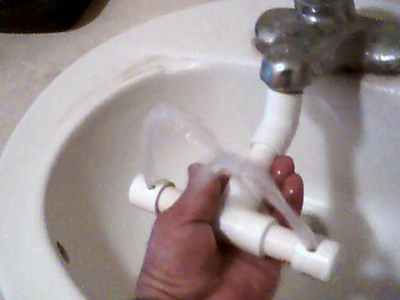

But what if you don’t have access to an open space like that or if the free time you have is different from your friends so you may not have assistants when you need them. Also once you start making rope you have to continue until you finish. There is no convenient place to stop if you have to and start again later. Thankfully there is a way to address those concerns and still make rope as long as you like. This involves using some heavy duty weighted spindles that twist the individual strands together and let the strands twist themselves into your rope. This is done a few feet at a time instead of all at once. As the second picture shows there is nothing special about the spindles. As you can see, they have a built in reel to hold the strand material and the bottom part holds the weight . As long as you stick to the basic idea of a spindle, you can use whatever you have handy to make them. They all work quite well. Since just about everybody likes to make rope out of plastic grocery bags the spindles I will show you how to make were designed with grocery bags as the rope material in mind. The spindle has to be rugged because it will be handled a lot and it will have to withstand a lot of different forces put upon it. My original spindles were made with peanut butter jars and dowel sticks with a can lid thrown in. They worked quite well and I made a 60 feet long rope with them. However plastic can deteriorate over time and I want you to have a set of spindles your children can use and pass on to their children.

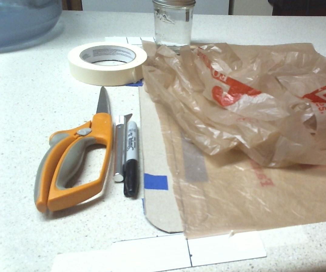

Cut the bags as shown. The handles and the bottoms of the bags are cut off leaving the middle. The middle is cut in half and the resulting rings are daisy chained together. Make 3 sets of 4 each. Because the knots will show, you have to position the strands so the knots are spread evenly along the rope. That means that 2 of the strands will have to be cut to make that happen. The pictures show how to cut the strands. Then the cut ends are then attached to the other end of their strands to even out the strands. The three strands should be the same length.
