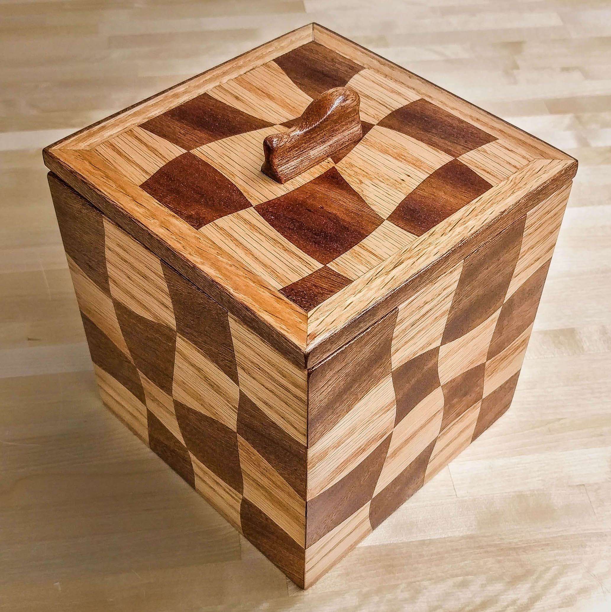

The wavy patterned background was inspired by Peter Brown's Drunken Cutting Board. I decided to make the pattern a little more uniform than his, so I used printed out sine and cosine waves from Desmos for the pattern. I then made a full scale drawing and made the distance between stripes about 1.5" on the edges. I could then use these drawings as a reference when tracing the lines on the wood.

Okay! We're finally at the fun part: cutting the pattern. First, you're going to want to make sure your mahogany and oak boards are exact same length and width. Then use four strips of double sided tape placed parallel to the width of the board to sandwich the mahogany and oak boards together.
Now, using the template you cut out earlier, trace only the waves running down the length of the board. Then, cut along the curves on the band saw, cutting through both boards simultaneously. Keep the cuts as smooth as possible.
Now you should have identical strips of both mahogany and oak. Remove the double sided tape and reassemble the two boards. Then, alternate every other strip with its pair of the other board. Make sure the waves match up and there are no gaps between strips.
Finally, glue each patterned board together. Use several bar clamps to apply pressure. Wipe off excess glue and check that there are no gaps along the joints. Wait 24 hours for the glue to dry before moving onto the next step.
Step 4: Cutting the Vertical Waves
Remove the clamps and run both boards through the surface planer just enough to flatten both sides of the boards.
Now repeat the same process in the last step, but this time cutting vertically. Start by using double sided tape parallel to the length of the boards, to sandwich the boards together. Make sure the boards are stacked in exactly the same orientation (If you were to see through the top board, the pattern would match the bottom board). Next, trace the vertical running waves and cut them out on the band saw. Repeat the process of removing the double sided tape, alternating the pieces, and gluing them together.
