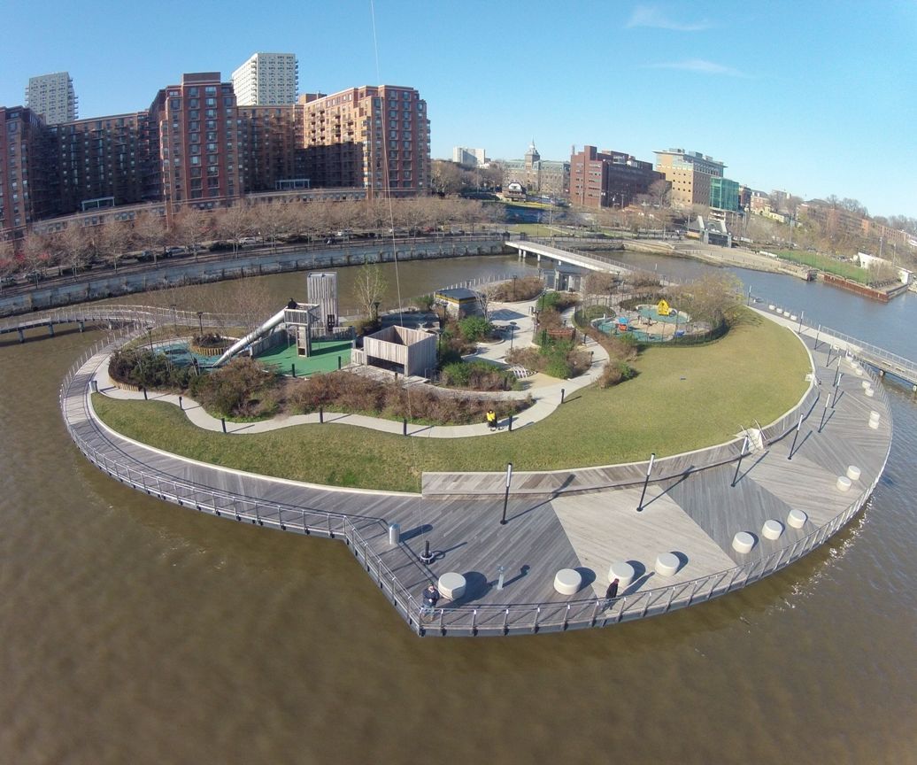

I took the picture of the Lighthouse at the Southern tip of Africa with a: http://www.cobrakites.com/ufoil30.html
but that kite is NOT a toy and should be handled with care.
Attach the Camera Rig to the kite line about 50 below the kite [ more stable ] and get the camera running and send it aloft, Remember to point the camera in the correct direction before you let it go up with the kite.
Enjoy your pictures, some of mine can be seen here: https://www.flickr.com/photos/142373518@N02/
