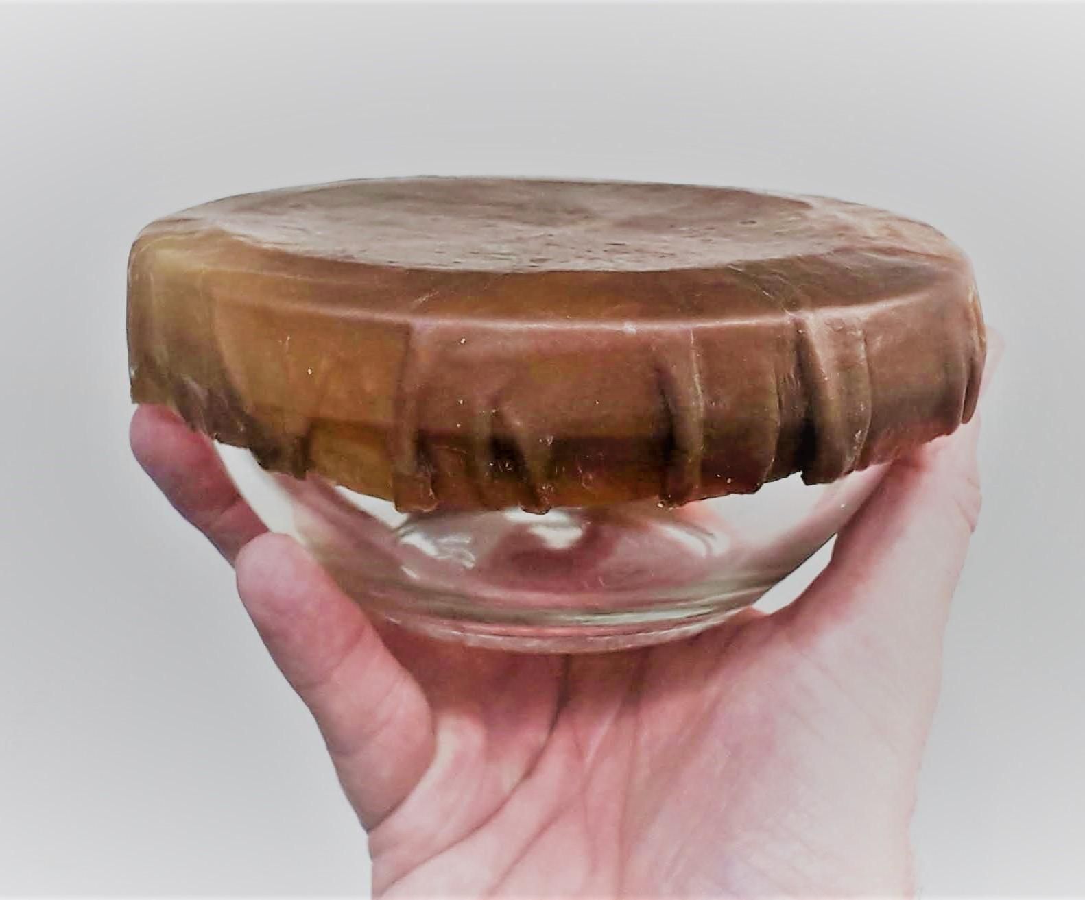

After 2-3 weeks, develop a gelatin about 1cm thick on the surface. Remove and wash with running water and soap with caring. Then dry in a piece of wood, the wood should be a plate or board, not varnished or sealed to help absorb water during drying.
PS: SCOBY(Symbiotic Culture Of Bacteria and Yeast) or mother culture can be obtained in two ways: you can receive a donation from someone who grows Kombucha or buys it over the internet.
Step 2: Drying
After some time the bacterial cellulose will lose about 97% of its water, and its color will change from milky white to dark brown.
It is recommended to turn the side of the S.C.O.B.Y sheet once a day so that drying occurs evenly
Be careful not to over dry and leave the material brittle as this will prevent your fold.

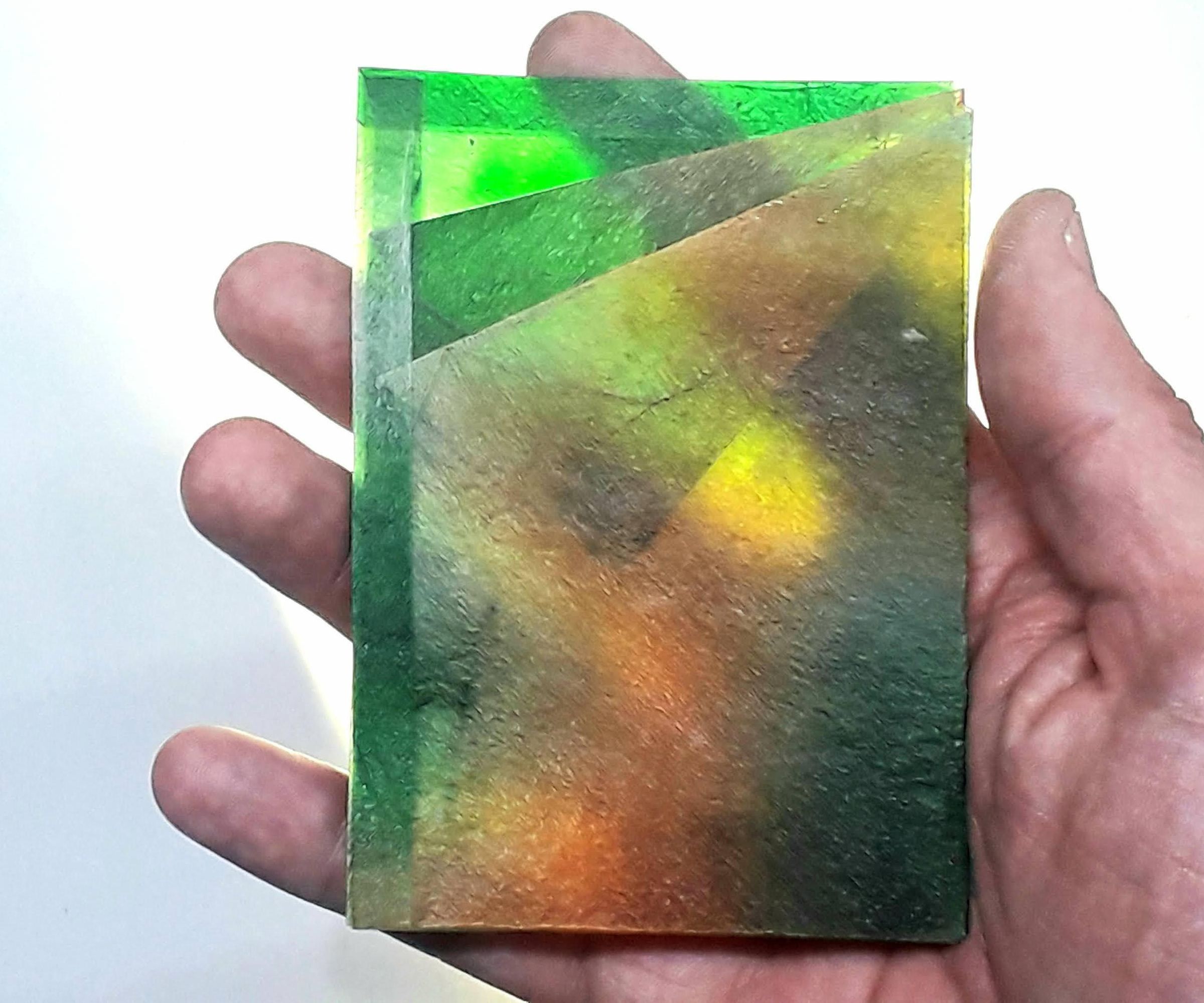

The first folds are on the left and bottom right sides that is 1.5 cm wide.
Then fold the top flap to the middle and bottom flap to the middle. You will notice in the side views that the ends are left over, fold these side flaps into the wallet.
Then just fold in the middle as in the last photo.
Step 5: Finishing With the Collage of Some Folds
To paste this material is very simple and environmentally friendly.
Wet the pieces to be glued and press against each other for a few minutes and that's it.
Glue the flaps with 1.5 cm, as in the photos.
Allow 24 hours to dry completely.
Now waterproof the wallet using carnauba wax and ready to use.
If your wallet is getting too hard and brittle, apply coconut oil before applying carnauba wax.
Never waterproof the cellulose with wax or coconut oil before gluing the parts.
