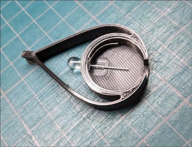

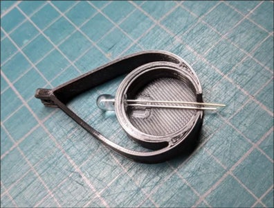

Step 3: Install LED
  1. Insert the LED deep into the 3D printed part's hole. The short leg should be at the bottom.
  2. Cut the two legs of the LED in half lengthwise.
  3. Bend the upper leg along the circle.
  4. Insert the CR2032 Lithium Button Battery and confirm that the LED lights up.

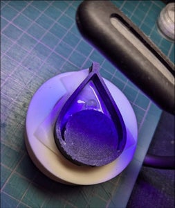

Step 4: Fill With Resin
Harden resin around the LED.
  1. Mask one side of the 3D printed part with the masking tape.
  2. Put resin a few millimeters thick and cure it with ultraviolet light.
  3. Add glittering lame and resin, then cure with ultraviolet light.
  4. Remove the masking tape and cure the opposite side.

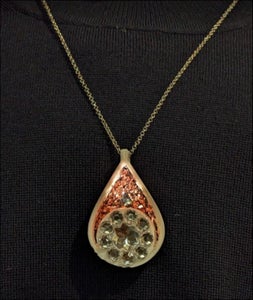

Step 5: Arrangement
Rhinestones and stickers can be used to decorate the pendants. It would be interesting to experiment with different colors for 3D printer filaments, LEDs, and resins. I also created an oval pendant. Although it requires more resin, the glowing area is larger than that of the drop shape.
The battery cap goes in when pushed in horizontally. To remove it, put a stick in the hole on the bottom.
