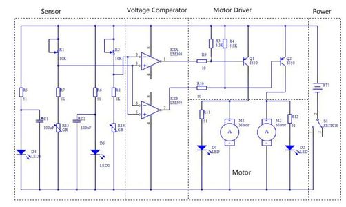

  • We need a circuit diagram as a reference for troubleshooting

Step 4: Troubleshooting
Case1: LEDs don't switch on, Motors do not switch on
  • Check if all the soldering contacts are proper
  • Using a multimeter test circuit connection, resistance and voltage drops
  • on my PCB I found that the ground was not connected to the leds and sensors
  • I used a jumper wire
