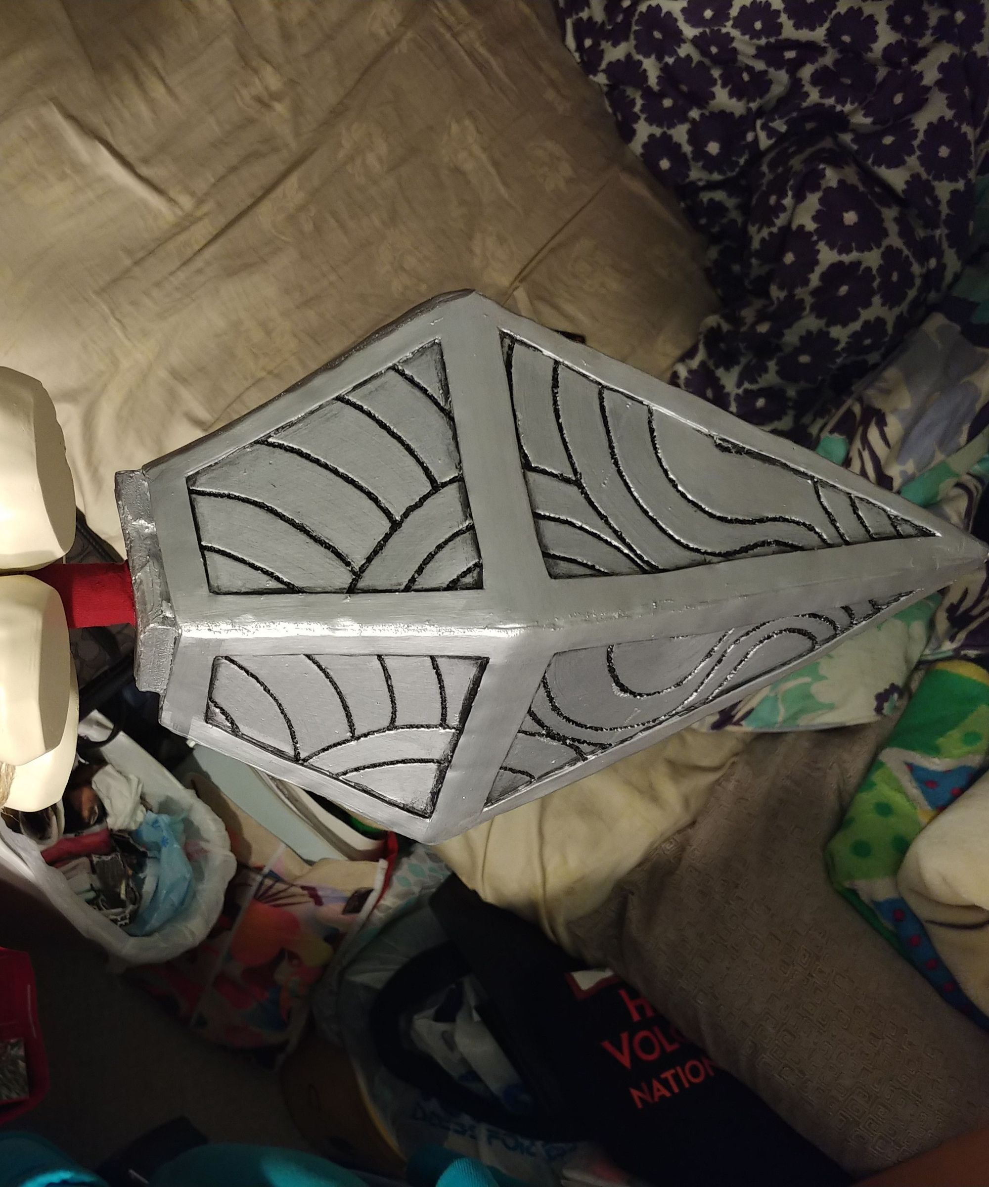

Silver Blade Piece- To attach this onto the dowel, my original plan was to have the Worbla base wrap completely around and adhere both ends to each other.
-Problem: In my measurements, I didn’t account for the wraparound width, so I ran out of Worbla to wrap around. I also realized that the Worbla wasn’t really sticking to the wooden dowel.
-Solution: You need to do this part in one setting, but it won’t take long and will need quick, heat-resistant hands (if possible).
First, heat the middle line of the base piece of the Worbla blade and add a line of hot glue as well. Immediately secure the dowel end on top of the Worbla and hold firmly for a few seconds before letting it sit at an even line to completely cool off so the piece doesn’t bend.
Next, heat the small piece of Worbla, add hot glue onto the open, opposite end of the dowel and place the heated Worbla piece on top.
Last, add hot glue and heat Worbla section by section until it completely wraps around the dowel.
