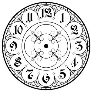

Step 1: Create the Artwork for the Face of the Clock
In Adobe illustrator or any vector based drawing program draw out the elements you wish to use for the design and shape of the clock.
You can also find an image of a clock face online and then convert it to vectors in illustrator.
If you are doing a 3D Model then you will need to import these drawings into the 3D program and extrude and bevel them to create your 3D model which you will be using for the relief carving.
If you are using 3D studio max then the entire model can be done without using illustrator.
Depending on the Cad/cam software you are using you will need to export SVG files from illustrator or STL files from 3D Studio max.
I have included the image and vector art I used for my design as well as an STL file I made in 3dsmax of a different design. any of these can be used if you wish.

I searched clock faces on google and then pulled the jpeg into illustrated and created outlines.
save as an SVG and open into carbide create.
