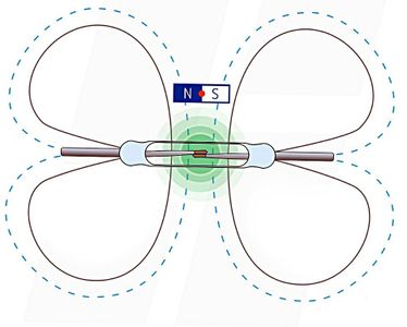

The principle of operation of the liquid level sensor is based on the interaction of a magnet and a reed switch. By moving the magnet along the two reed switches, switching occurs.
The reed switch reeds are magnetized according to their attractive magnetic polarity. Thus, the force of the external magnetic field of attraction causes the contact to close. Any residual magnetism on the reed blades interacts with the reed switch's opening and closing.
There is a triggering due to the magnetic field, and the contact on the reed switch is closed. Accordingly, this turns on LEDs that glow a certain colour, indicating that the tank is filled with liquid to a certain level.

The reed switch consists of two ferromagnetic conductors enclosed in a hermetically sealed glass bulb. An inert gas (nitrogen) may be present inside the capsule. Thanks to nitrogen, the maximum switching voltage limit increases. That is, it becomes possible to use it in electrical circuits with 220 V. Instead of an inert gas, the capsule can be evacuated. This allows the reed switch to operate at high voltages (thousands of volts).
The contacts of the reed switch are made of ferromagnets and can be coated with erosion-resistant metals such as iridium, ruthenium, or rhodium. Spraying allows you to repeatedly increase the number of operations up to 5 billion times!
There are reed switches with mercury contacts. Mercury provides reliable operation for contacts and also reduces their bounce. Such reed switches require installation in the correct position, as otherwise droplets of mercury can connect the contacts even in the absence of a magnetic field. There are closing, opening, and switching reed switches according to the type of operation.
The principle of operation of the reed switch is very simple. When exposed to a magnetic field, for example, from a permanent magnet, the reed switch contacts are polarized and triggered—they close, open, or switch. The reliability of its inclusion depends on the orientation of the magnet. That is, with what pole it is turned and movement relative to the reed switch.
