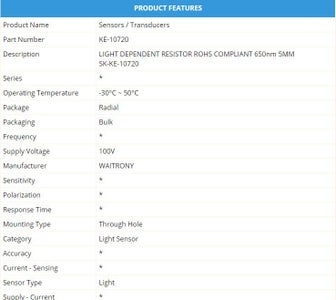

In the circuit I developed, the light sensor is a photo resistor PH, which, together with the trimming resistor R1, forms a voltage divider. This allows you to change the level of the controlled voltage at the base of the transistor VT1. As soon as the light level increases, the decrease in the resistance of the photo resistor provides enough voltage to turn on the PNP transistor. It is no coincidence that this type of transistor is used; it opens with a negative voltage. If you use a transistor with a NPN junction structure, the circuit will work in reverse. That is, the transistor will open at dusk to allow the device to operate at night. This circuitry can be used if you need to turn on, for example, an LED lamp. Turn it on when the level of natural light decreases.

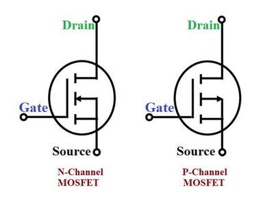

Step 3: MOSFET Transistor

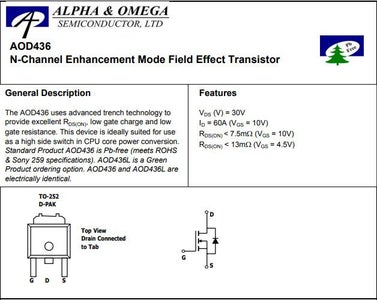

I want to talk about the use of a field-effect transistor as a key in this circuit. I used a small-sized TO 252 transistor, which I found in old computer motherboards. Usually, low-voltage radio-electronic components with a switching threshold of about 4 volts are used. If you use other field-effect transistors, you must take into account their operating voltage.
MOSFET transistors (metal-oxide-semiconductor field-effect transistors) have great advantages in such circuits:
They use minimal power management and have high current gain. Also, it is resistant to large voltage surges. In key mode, they have a faster switching speed. Thus, in this circuit, the use of a field-effect transistor simplified the circuit design of its connection and reduced the level of hysteresis during its operation. Initially, I set the task of creating the simplest possible photorelay circuit to control bioacoustic bird scaring.

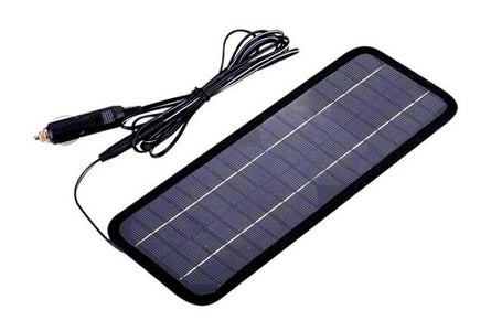

As an additional power supply, a 1-2A pulse power supply with an output voltage of 5 volts to 50 volts can be applied. But since this device is autonomous, I used two 3.7V/2A lithium-ion batteries. It is also possible to provide an external power supply by applying car batteries. The most welcome is to provide an autonomous power source that can be recharged from the sun. I used a small 12–18V solar panel, but enough to recharge the device's battery. To correct the voltage, I applied a DC-DC Adjustable Step Down Converter from 4.5–50V to 3-35V/2A (LM2596HVS). But a converter with a lower output voltage, for example, the XL4015E1, would also be sufficient. Since the battery charging current does not exceed 1 ampere, it is better to use a small converter. That's an output voltage that can be adjusted within 5 volts using the on-board potentiometer. For additional recharging, I applied a standard TP4056 Lithium-Ion battery charge and control (BMS) board. For such devices that are meant to be operated in an external environment, the most recommended is a solar battery.
