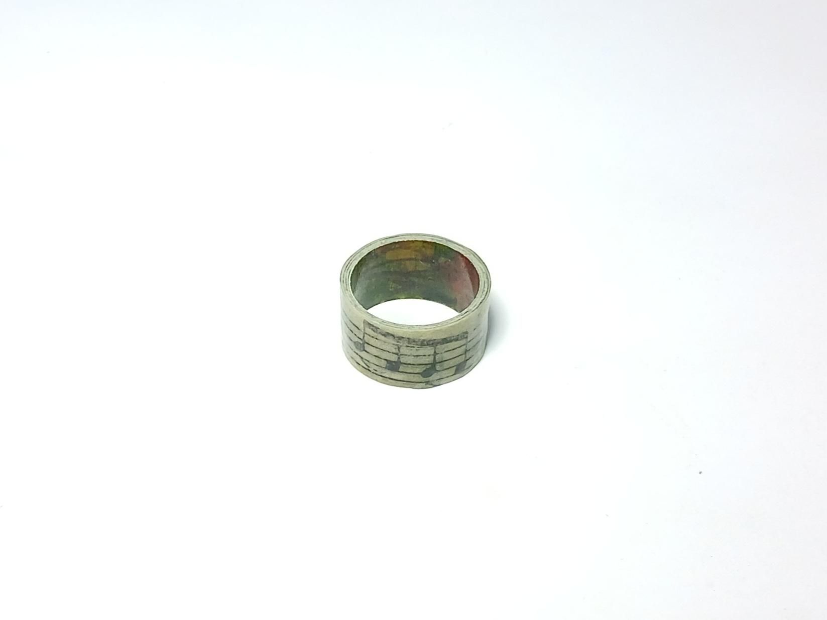

The ring we are making in this Instructable will be using old book pages and sheet music that has been soaked in epoxy resin and wrapped around a cylinder to create the layers for the ring.

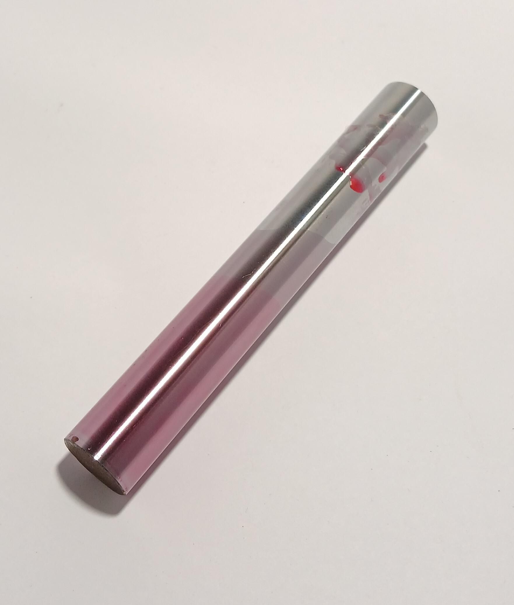

Step 2: Prepare Your Mould:
First step is to prepare your mould as it needs some time to dry.
For my mould I'm making use of a stainless steel rod that is the same size as ring I want to make.
Now in order for us to be able to remove the ring from the mould after it has been made we need to cover the rod in a release agent.
There are a lot of products out there from waxes to spray cans but I've been using PVA release agent since I've first started working with resins and have never encountered any problems, plus it costs a fraction of other fancier release agents.
To get a smooth glass like surface on the inside of the ring we will need a smooth coat of release agent as any imperfections will transfer over to your resin.
The best method I found was to simply dip the rod into the PVA, then placing it upright on some old newspapers to let gravity do its work and get rid of the excess.
I repeated this process twice to get a nice thick coating, letting each coat dry completely in-between.

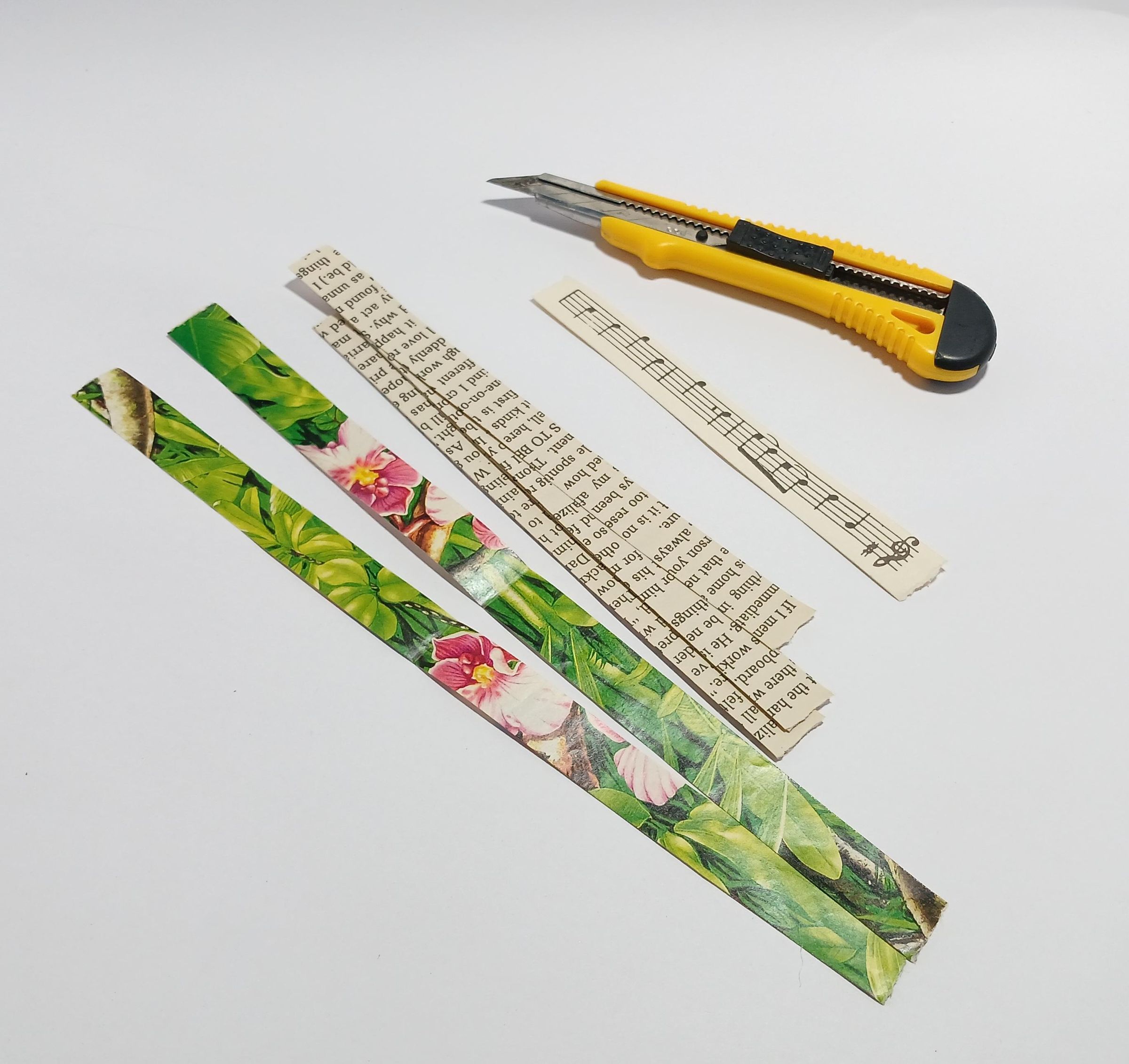

The bulk of the layers are always made from book pages I take from no longer usable books, it doesn't matter if there are damage to the pages in fact I think it just adds to the character of the finished product.
For the top and bottom most layers we will use a more decorative paper, with this ring I went with some tropical pictures from a magazine for the inside to add a pop of color and then the outermost layer will be an old music sheet.
I used a sharp hobby knife to cut down the papers into strips of about 10mm (it needs to be about 20% bigger than the width of the ring you want) the amount of strips needed will depend on the thickness of your ring, all together my strip was about 80cm long and gave a ring thats about 1mm thick.

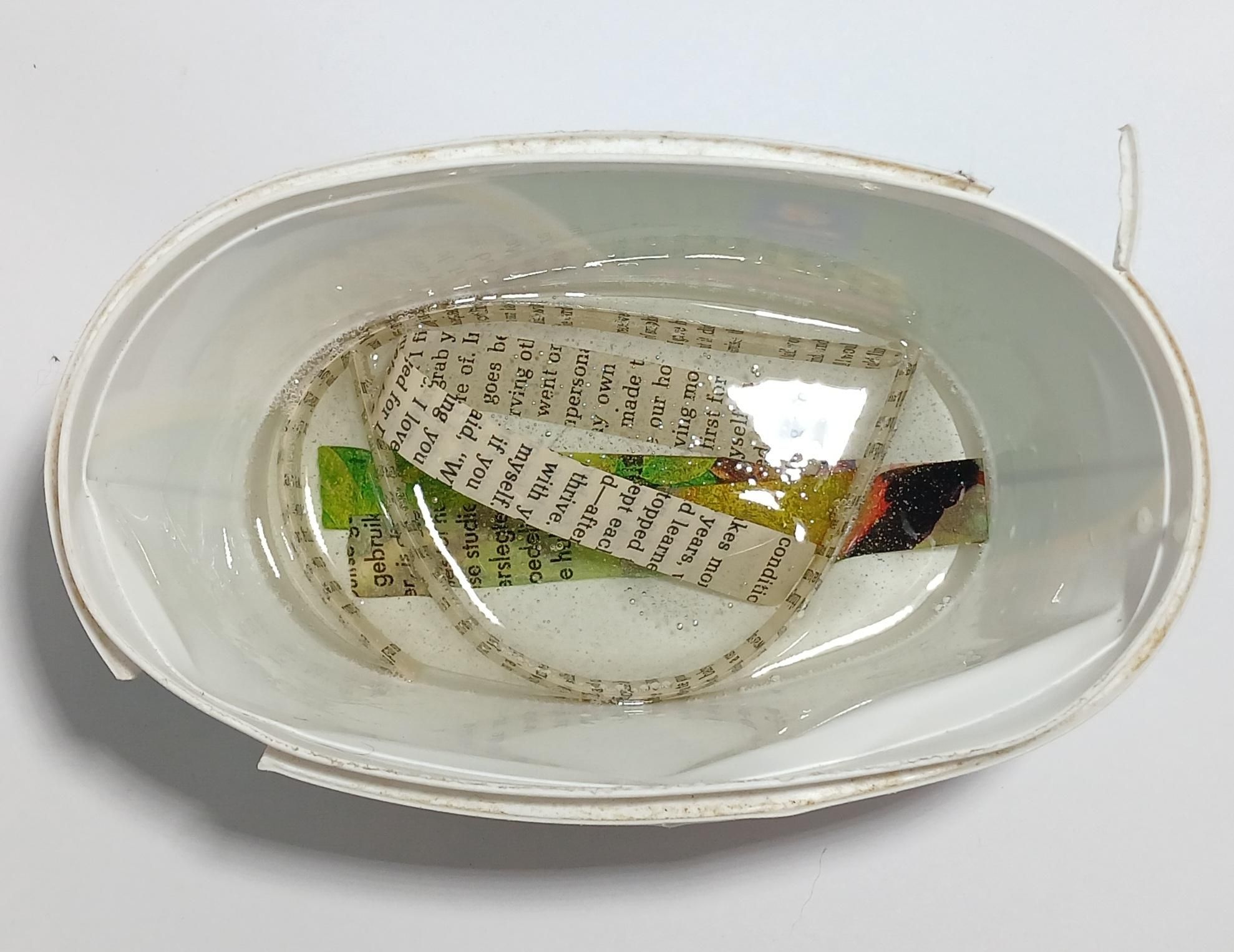

After all your strips are cut they need to be soaked in the epoxy resin.
I mixed up 80mg of epoxy resin for the paper, this is way more than needed but will ensure that the paper strips get coated evenly as unsaturated paper will cause the ring to not be waterproof.
Always wear proper skin, raspatory and eye protection when working with resin and other chemicals.
Follow the mixing instructions of the manufacturer carefully, my resin is a 100:60 mix ratio so I used 50mg of part A and 30mg of part B.
As this resin has a few hours of working time I can let the paper strips lay submerged in the resin for a few minutes to ensure proper saturation.

After the first strip I wrapped around two story book strips followed by another strip of the colorful tropical strip and then finally I finished with the strip of sheet music.
To keep the lamination compressed and free from air bubbles I wrapped the finished ring in some painters tape and added a elastic band around it to prevent it from coming loose as the resin will prevent the tape from sticking.
Set aside and allow the resin to cure for at least 24 hours.

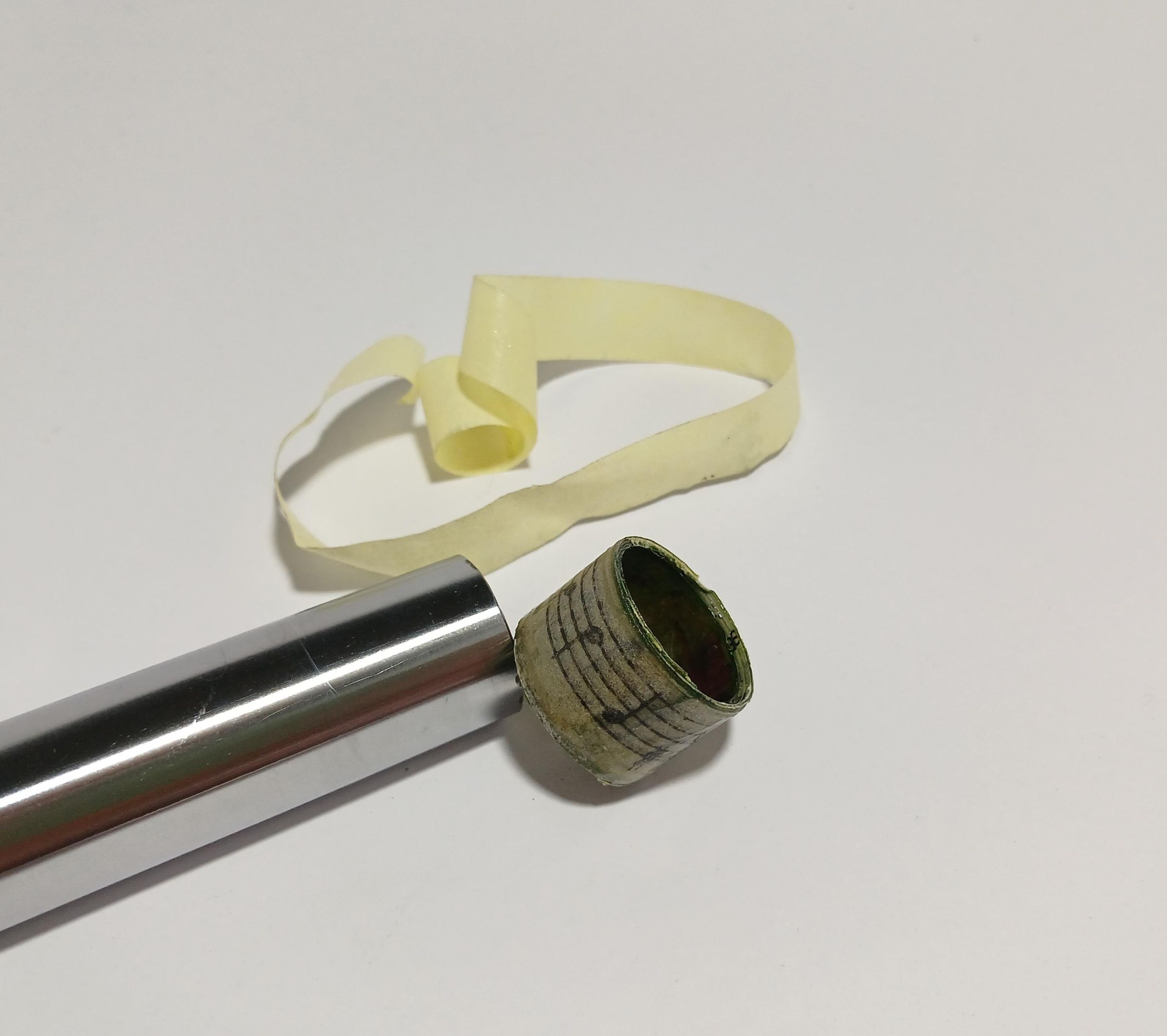

After 24 hours I removed the elastic band and painters tape from around the ring and placed to mould into water to let the PVA release agent dissolve.
After about 30 minutes I removed the mould from the water (make sure the PVA is washed away) and tapped the top of the rod with a small hammer while holding onto the ring and it popped loose.
Thoroughly wash the ring to get rid of any PVA residue.

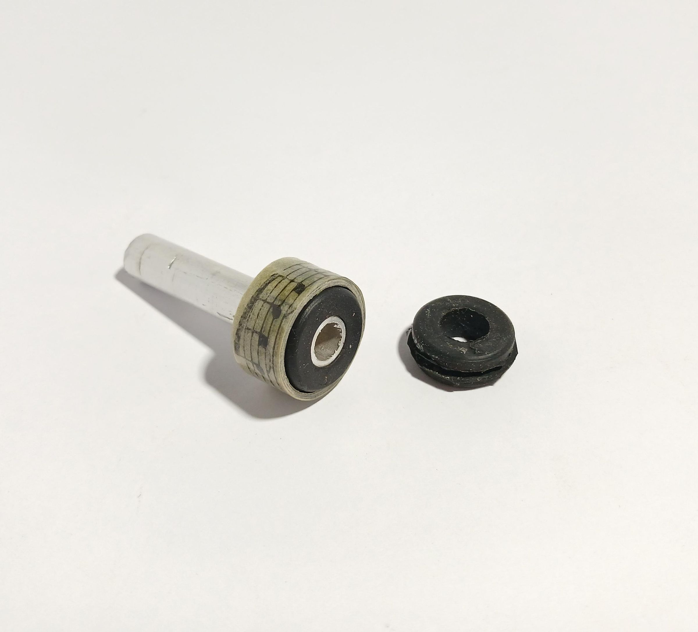

Next I made a little DIY jig that I can place into my drill in order to sand around the ring and bevel the edge.
I simply took a piece of 10mm aluminium pipe and put two rubber grommets onto it this held the ring perfectly and made sanding a breeze.
