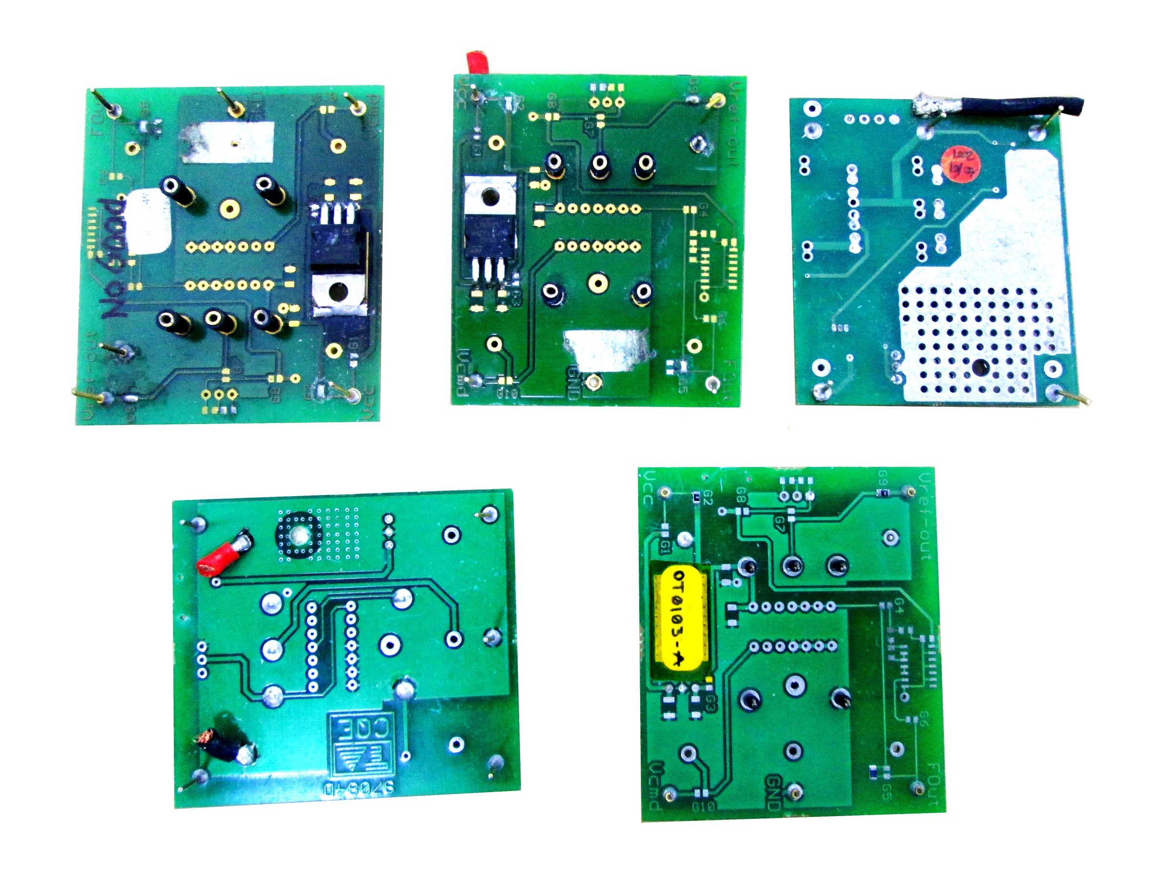

Step 1: Look for Materials
A pile of discarded PCB.
If you don't have scrap PCBs lying around try to look into you neighbors junkyard.
Electronic equipments surely have one of those. Its just sad that these parts are being "junked" and add up to the hills of garbages around.
Tip: Choose the PCB with least components to shorten desoldering process.

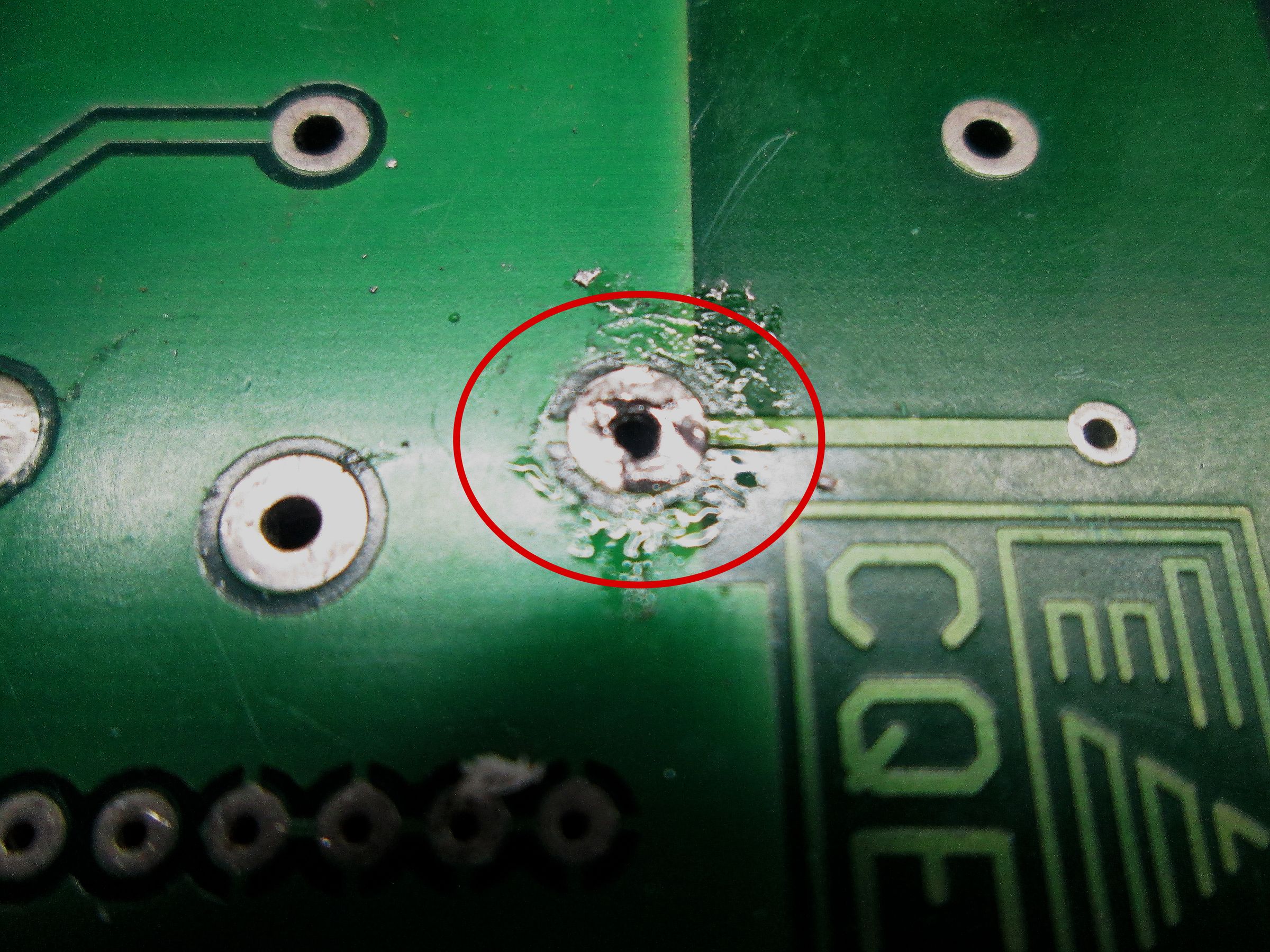

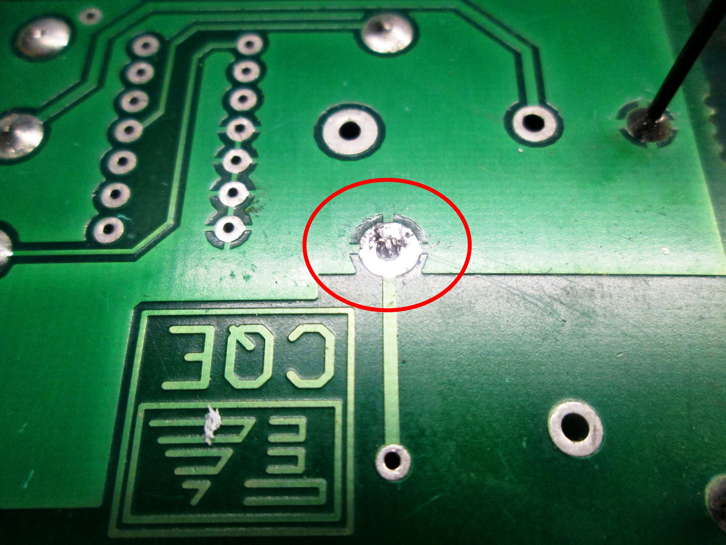

Step 4: Desolder Components
You can start with the smallest to the biggest components (or biggest to smallest depending on your convenience preference) when desoldering.
- Melt the solder from pads of PCB using the tip of your soldering iron.
- Squeeze the desoldering pump lever to lock then point the nozzle to the melted soldering lead.
- Then press the button at the pump to suck those melted solders.
Sometimes you will encounter stubborn parts where the solder does not go out when you use the desoldering pump. One practice is to add more solder lead onto that part then try desoldering again. You do this 2 to 3 times until the part goes off.

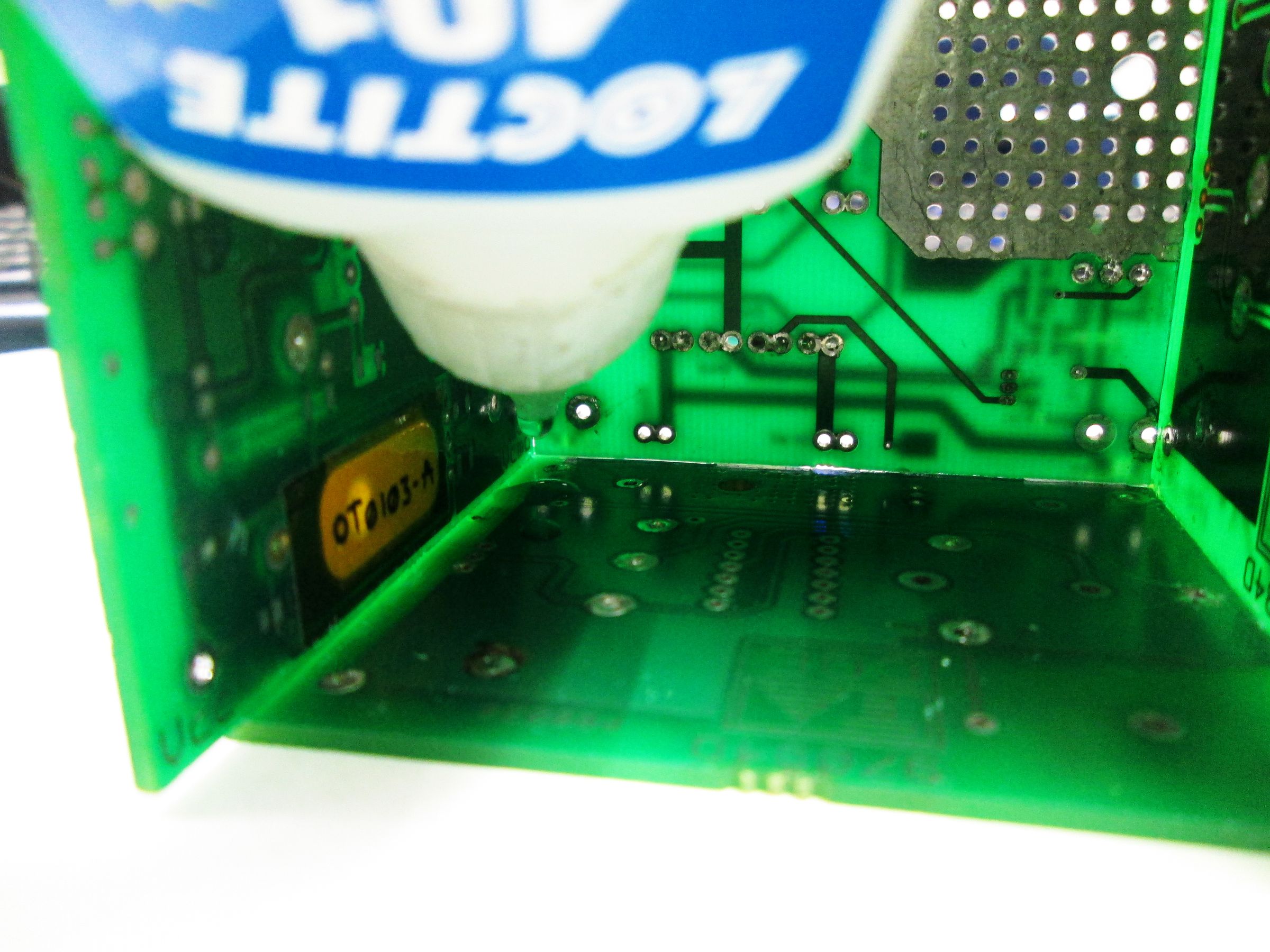

Step 10: Add the Last Touches
Apply glue in the inside corners.
This way the added glue will provide better sturdiness on the planter. Doing this would require the planter to set for several minutes (until the glue is totally dry).
