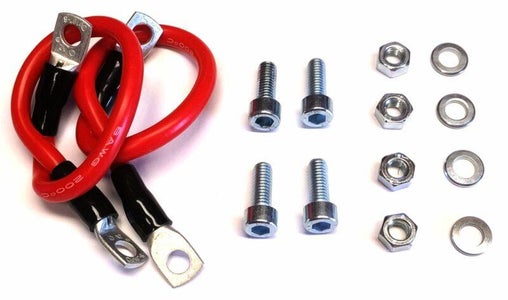

Step 4: Connect the Positive and Negative Power Line With Connecting Pieces
Step 5: Connect Power Line
Step 6: Connect the B- of BMS to the Negative of Battery Pack
