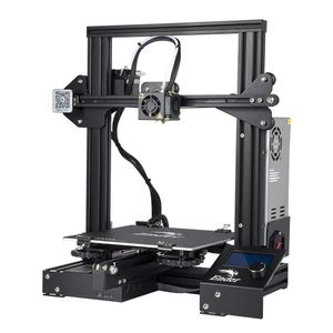

  • Access to a 3D printer

Usually with these types of projects are refined using a lathe but as most makers out there I lack access to one so I designed the mold that the inner takes a 5mm bolt that can then be fitted to a drill for a makeshift lathe.
This is a low filament use project that has no supports and can be printed with any filament.
